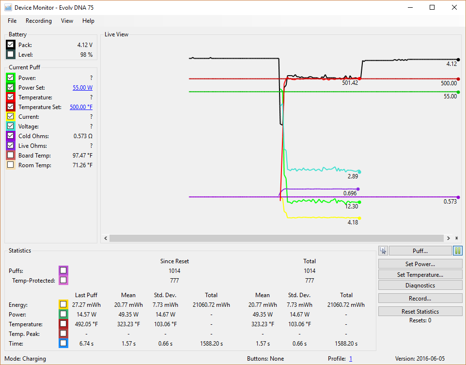

  1. Hey the V3.5 is much better with this wire. You nailed it thank you very very much! Temp coefficient settings in my tube mod must be very similar to this profile since I'm getting the same vape now at right around the same temps. I tried his v3.25 and it wasn't much better so that's what had me spinning. Should have kept trying the other ones! Again thanks much for your help. All the best -
  2. Oh wow just reading this. I will check the profile specific to this wire. So greatly appreciated!!! I will report back. Many many thanks
  3. Hi yes that's the steam engine profile. Also tried a recommended one from Jaquith with same results. Wire is 26g from Master of Clouds 316L and yes vape at 570-600 is same as 450-480 using my tanks and dicodes mod. Therion BF DNA 75c also the same so honestly no idea! I hope I'm doing something wrong
  4. All 3 firings (450, 500, 570) gave the "Temp Protection" warning. I was firing without taking a puff (I'm in my work office) so hopefully these results can tell us something. Only solid vape is around 580 - 600F which is not normally my go-to temp for the same wire/wrap/etc.
  5. FYI coil is 26 g, 8 wraps around 3mm id. Mod reading around .58 Cold Ohms a bit lower at .573 - not sure that's making a difference.
  6. Shoot sorry these graphs appear meaningless without the values. Let me try again.
  7. Yes I'll try - and thanks for the help. What software is recommended to get a rolling shot of the of the Device Monitor while firing? Does the record function allow you to paste it in here?
