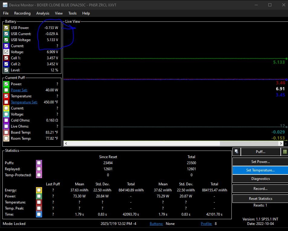

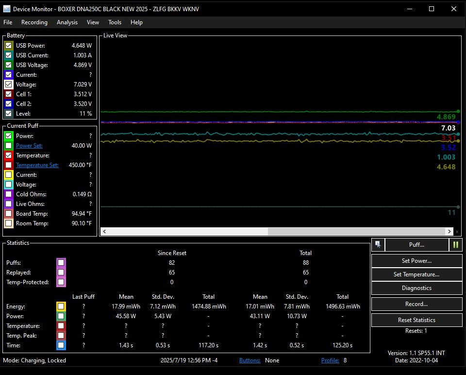

  3. I have a charging issue that I can't figure out and asking for any help. here is what is going on i'm working with I have pair of 250c mods one I built wont charge and a brand new boxer dual 20700. these are brand new batteries sanyo 20700 swapped between both mods to verify they aren't the issue. I'm using everything the same as in USB cable, same PC port ect. here are the device monitor screenshots one is the clone mod I built myself a few years ago and has been charging but no longer and the other is from a brand new boxer dual 20700 just swapping batteries between the mods

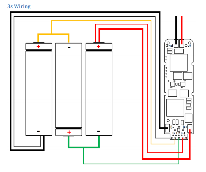

    on the board did you jumper the the last connector pin 4 either back to 3 or to B+? do you see each cell voltage in device monitor? when I was ruining it in 3S I just jumped it to the B+
  12. KMac
    My N1 250C
    Are you using a 3S or a 4S? I've used a 3S for a week or so while waiting on the 4S to arrive just need to switch the config in Escribe but no issues at all for me.
