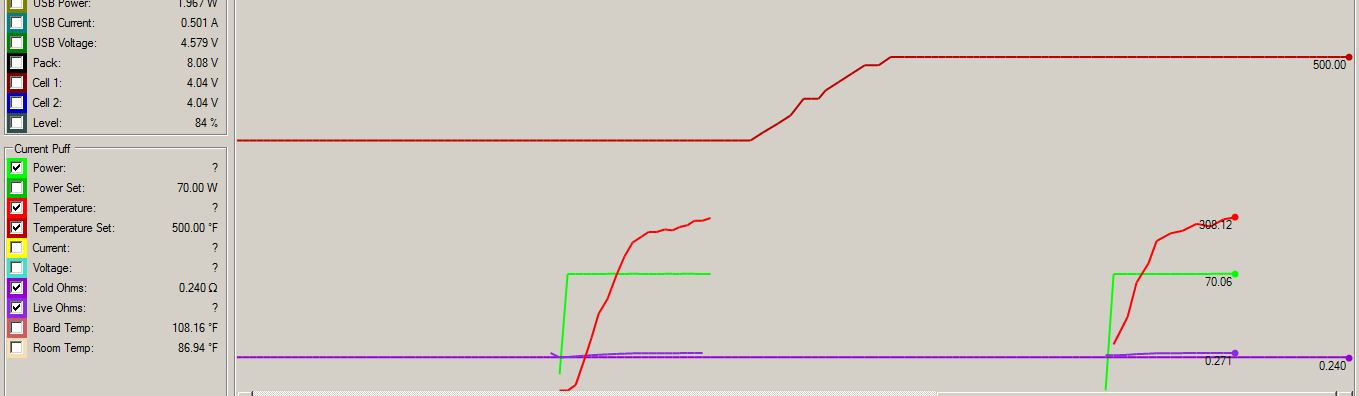

  1. Well, 30 minutes later and After rebooting escribe it behaves exactly like i would expect it to sooo idk. I'll update any new info that comes up.

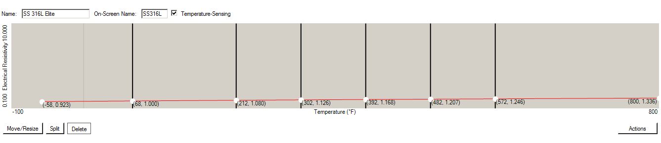

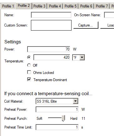

  2. Trying to set up temp control on my Paranormal 166. Currently running SS316L dual triple core 30/38 claptons ohming out at 0.25 ohms. For some reason the measured real-time temp doesnt ever reach set temp. For example I set it to 400 degrees it only goes up to 300. This is at all wattages. But it feels hotter than 300. I can move the temp higher and it doesnt do anything. I can move it lower and it wont do anything until it reaches the temp its reading real-time. Do I have some settings messed up somewhere? See photos. Thanks, Josh
