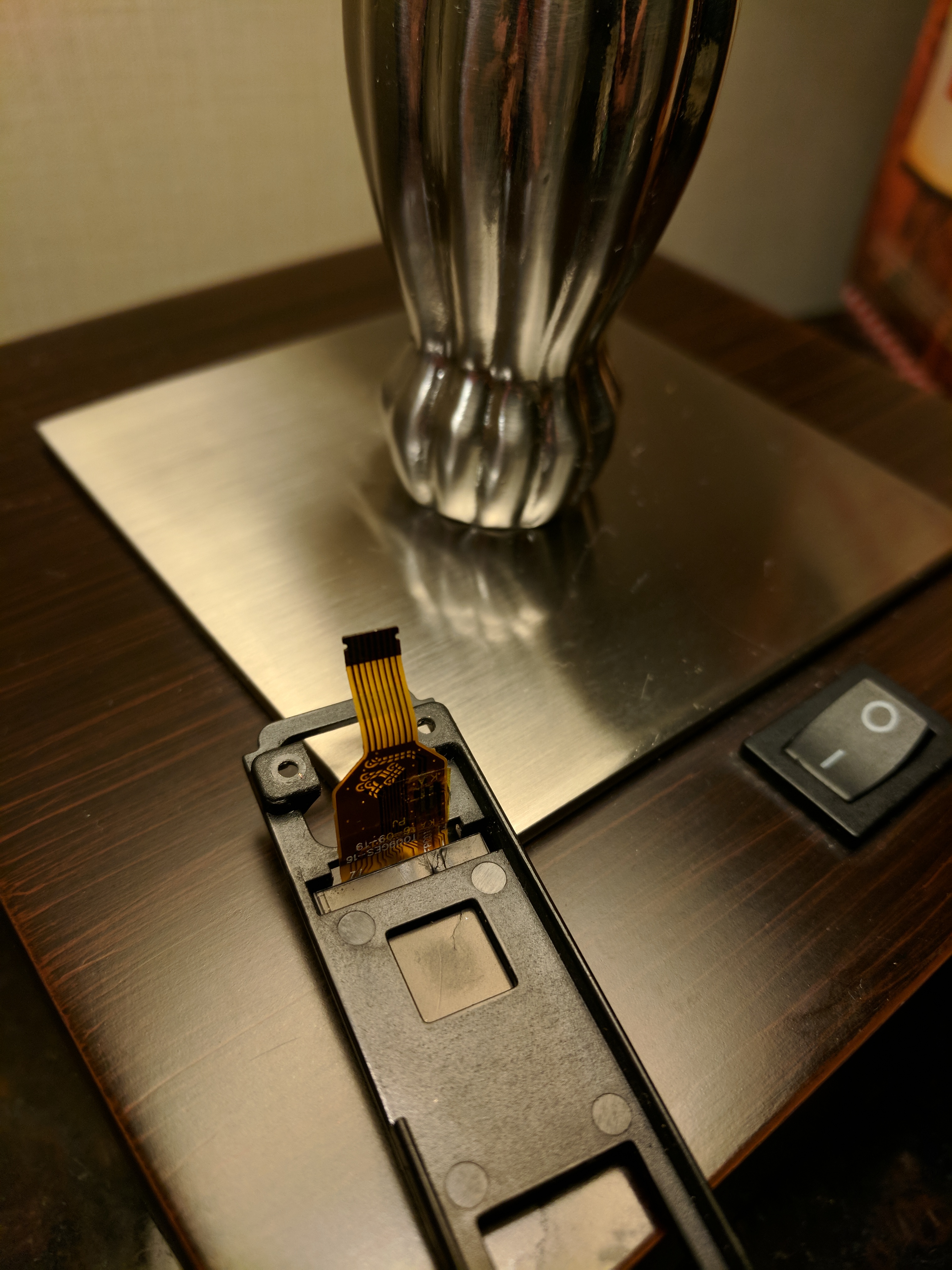

  1. Tim https://www.evolvapor.com/products/dna75color Right under board for $12
  2. Also Tim make sure you look at the screen plug before unplugging old one. The ribbon goes in to a certain point i thought i broke my new screen come to find out I did not have if plugged all the way in.

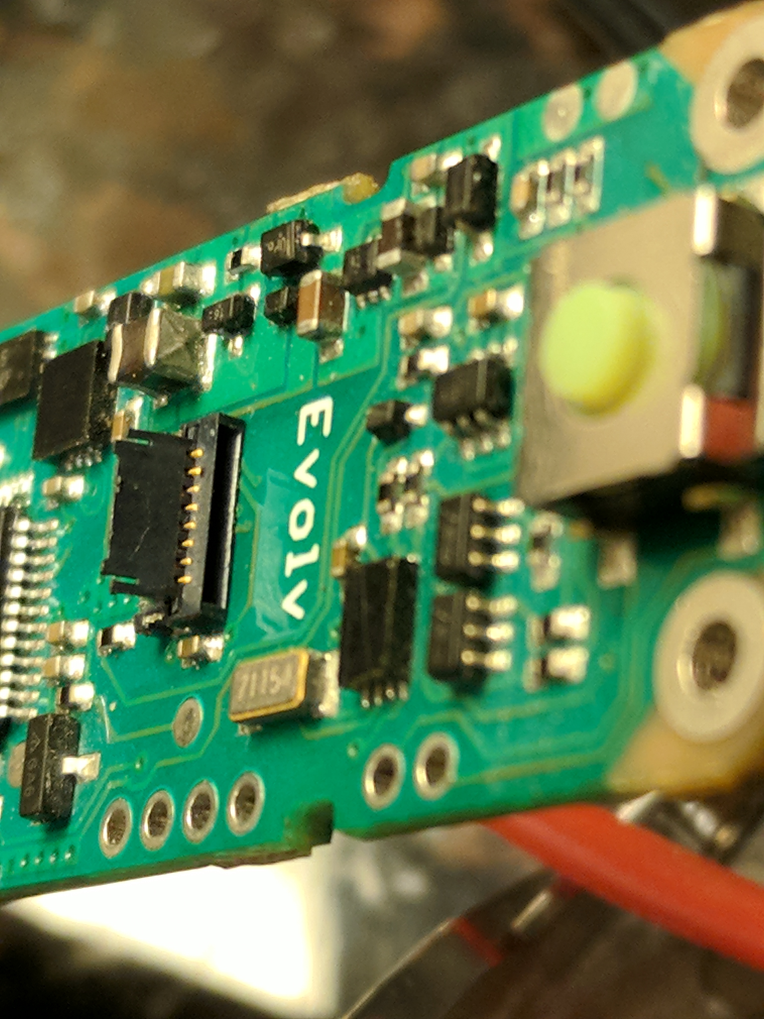

  3. Tim and sham. I'm at work right now so this will be brief. Sham take the wood panels off screws underneath. Probably already figured that out by now. Tim I bought it from evolv. Be carefully while messing with the board it is really to break soldered positive and negative wires to battery. The screen can be a really pain in the butt to get plugged in. Be very careful with ribbon plug on board it will break super easy. Deep breaths give yourself plenty of time to work with it. Don't force anything if you are going to sneeze don't hold the board it will break. Now that being said pay attention to where your wires are tucked into on body they only fit 1 way.
  4. Thank you Thank you thank you! Got to looking at my connection. I realized that I could install the screen then put it in the screen holder. Once I realized this I was able to push the cable in a lot further than before. To anyone reading this with the same problem the ribbon is installed black side facing away/up from the board. The ribbon is inserted till there is only about 1/16 of the black part still showing. Be very careful and make sure it is straight. I wasn't inserting the ribbon into the zif socket far enough. So happy to be back to my dna I had to switch to mech mod while it was down I was miserable. 🤣😂🤣😁
  5. Here are pics of my zif socket which doesn't look damaged in my opinion. But what do you guys think? This is probably a dumb question but just trying to rule out stupid. Is the black part of the cable from screen suppose to be installed up or down.
