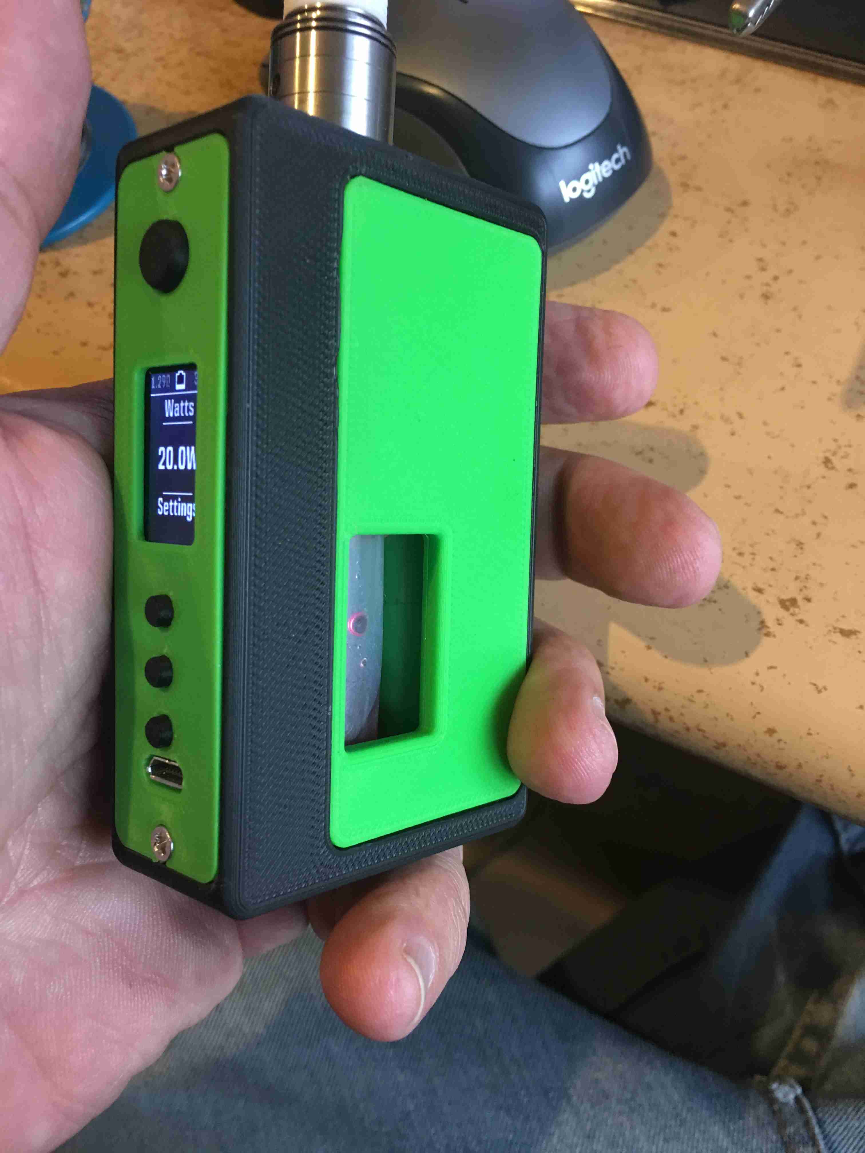

  3. Good Day to All, I apologize for my not native English! I just got my first 75C and I am testing it. I installed it on a custom made 3D-ABS BF box - The cables I used are silicon insulated on positives and silver for negatives/gnd - gauges are as per Evolv specifications - I inizialized the device with Escribe 2.0 SP 7. Profile : Watt - TC DISABLED (Off everywhere is possible lol) Electrical connections are solid and installation is done quite well (Even if is my first 75, I have installed many mods with Evolv devices from DNA20 upto DNA250 so I am sure about this specific hardware installation) I am testing two different sets: 1) My Origen Little - Standard Ka1 0,25mm (30ga) x1 - 4 onto 3 coil wraps - something like 1.3 Ohms - it is working perfectly from 13W upto 20/25W 2) My MB Chalice-IV - Twisted KA1 0.32mm (28ga) x3 - 5 onto 4 coil wraps - something like 0.21 Ohms - it does'nt like to work! Every time I press Fire - from 13W upto 40/50W - the device starts screaming "Temp Protect" (Of course at 13W it gives you 1/2- 1 sec time to fire while at 40W is not firing even for a millisecond) How that is possible? In Watt profile, temp sensing should and is disabled - I rised up all temperature values (they should not be read if TC is off but - just in case!) I am sure I am doing something wrong, but what ? I never used Escribe 2.0 - and very few time the older 1.2 sp5,2 on my DNA200/250 devices and never found such a case. (I love my simplier DNA20 and DNA30 for that! LOL) Thank so much for any reply, it would be of much help! Ciao Andrea
