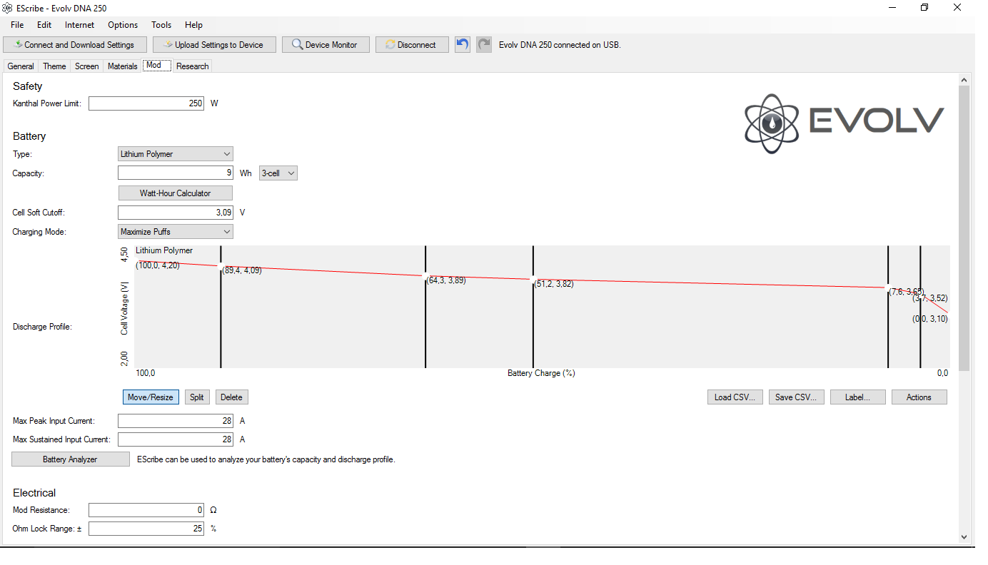

  1. Thank you. Yeah, I usually stay around 0.3, you are right. Well, now the battery is fully charged and the wh went from 9 to 14.7 after the battery analyzer so I hope I've managed to fix it. I will let you know if anything doesn't work propertly. Thank you very much, you've been clear and helpful.
  2. Good morning Lowbytes, I've just run a battery analyzer and this is the screenshot. Now the wh is around 14. I'm attaching a screenshot of the device monitor too, the box is now charging. Thank you

  4. Hello everyone, I got this issue with my vtbox250 by VapeCige: when the box is fully charged the battery percentage on the screen drops dramatically after every puff. I don't believe the percentage shown reflects the true battery level, still it is quite annoying as it represents the only minor issue of an otherwise exquisite box. I believe it might have something to do with the wh parameter, so I attached what I see in eScribe. Thank you all for your help
