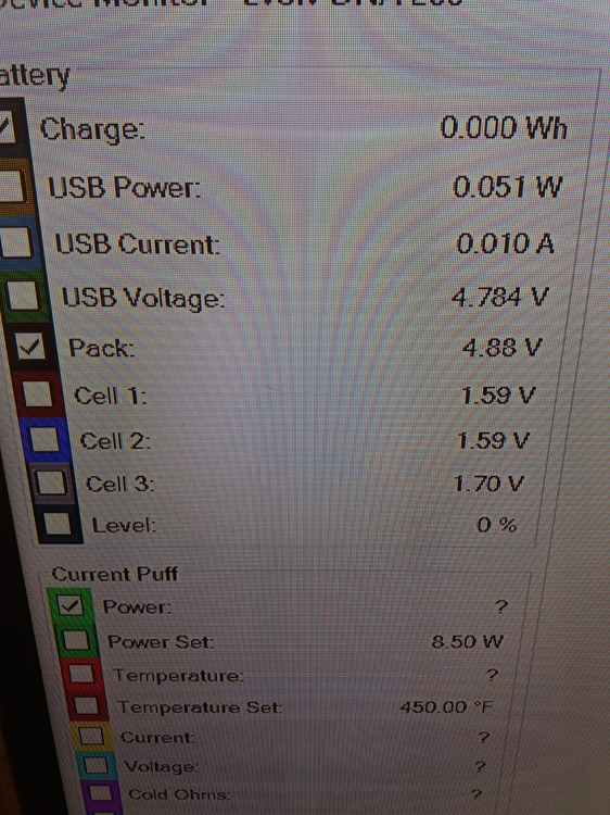

  1. Many thanks for your help. New battery ordered and should be here Monday or Tuesday. Ordered a like for like with the same XT30 connector so should just switch straight over.
  2. Thank you. I'm tempted just to get a new battery in that case. I did try the USB recovery (I've been messing about with escribe trying to get it charging) but nothing yet.

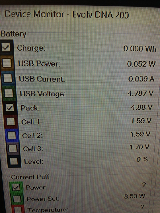

  3. Hi all, I posted this in the DNA200 section but seems more appropriate here. Received my first DNA mod this morning, a Lost Vape Halcyon. Bought used as just can't buy them new anymore and was the one I wanted. I'm having some charging issues, basically it won't charge! Have a minimum amount of power in the batteries but I've tried two separate cables, tried every USB port in the laptop and tried a wall plug. Nothing. It connects to escribe just fine. I've attached a pic of escribe. Is it something daft like I'm using wrong type of cable or is it basically knackered or do I just have no clue what I'm doing yet? Thanks.
  4. Hi all, Received my first DNA mod this morning, a Lost Vape Halcyon. Bought used as just can't buy them new anymore and was the one I wanted. I'm having some charging issues, basically it won't charge! Have a minimum amount of power in the batteries but I've tried two separate cables, tried every USB port in the laptop and tried a wall plug. Nothing. It connects to escribe just fine. I've attached a pic of escribe. Is it something daft like I'm using wrong type of cable or is it basically knackered? Thanks.
