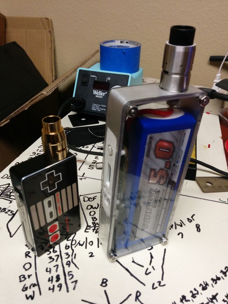

Here is my DNA200 Alpha Build, I have lots of plans for a more refined case. This one was quick, and easy to make. The case is made from bent aluminum bar stock and Lexan panels on the side. I gave up trying to carve out all the holes for the screen and everything with a dremel, so I just 3D printed a sled and glued it into the case. Got to print some smaller up and down buttons, as the ones that printed with the sled were too large to fit. The battery is a Turnigy 5000mah, a bit excessive but I get several days solid vaping at 100+ watts with my usual .2 ohm builds. I plan on installing an XT60 connector between the battery and board, just did not have any at the time. My next DNA200 build is totally going to be something a bit more pocketable. The battery is way to big to carry around everywhere, but I am loving this DNA200 chip! Thanks to everyone here on this forum, it is a fantastic resource!
