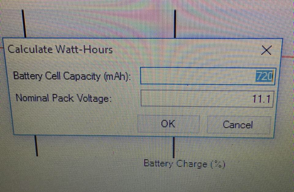

  1. You can let 'er go through 5 or 10 charge/discharge cycles over the next few days to work in the pack and then run battery analyzer and case analyzer. In the mean time, 11.1V x 1.3Ah = 14.43 Wh. You can use 14.43Wh as close enough. The battery is very likely around 1,300mAh real capacity. As far as I know, the only thing the battery setting affects is the battery gauge (although I wonder if it also affects charging). If you still like it after a few days, please let us (and me) know. I suspect everyone not having problems are remaining silent so the only things I've read are problems.[/QUOTE] Ok so I done the battery analysis and it comes in at : 12.91 WH 1150 MAH very odd but that's what the program shows. Also running this test is dangerous, the VTBOX got very hot to the point that I couldn't touch it and it will destroy any coil you have attached to it.

  3. Hi guys I'm trying to find out what the actual battery cell Mah is of the battery inside the VTBOX also I would like to change the settings on Escribe to sort out what seems to be wrong data for what the actual battery is. Any help would be greatly appreciated all. The image attached is what seems to be the default setting which I believe to be wrong and the WH is set at 9 by default aswell Once again thank you for any help given
