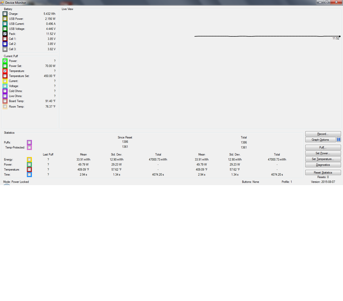

attached are settings dna200.zip
it also gave me a weak battery message at 10.9 volts.
ok so i just let it charge overnight and the battery indicator and volts seemed to match up. But I noticed that the battery didn't last as long compared to previous session. Anybody know what I can do to fix this? Thanks
When I checked the battery on escribe all 3 cells were balanced and fully charged.
I charged my hanamodz v200 and the volts says 12.6 but the meter showed about 3/4 full. Still works but what could the problem be?
