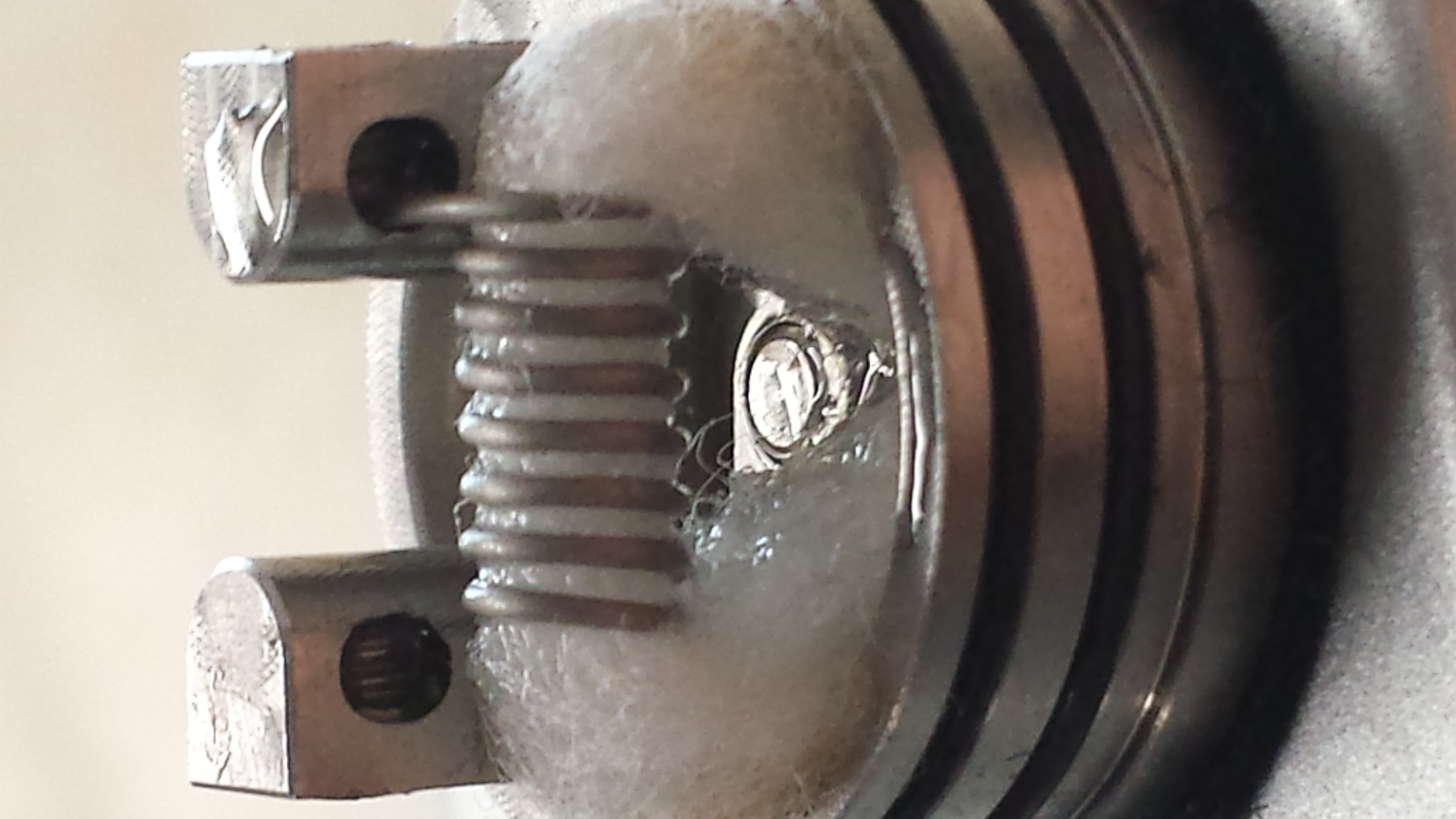

	  Titanium set up issues.RunsWithOtter replied to RunsWithOtter's topic in EScribe, Software and Firmware That's why I'm posting everything I'm doing to see if anyone has any insight into what is going wrong. I posted the picture and said I was getting hot spots, and I'm aware that burning cotton at 450 degrees isn't right.

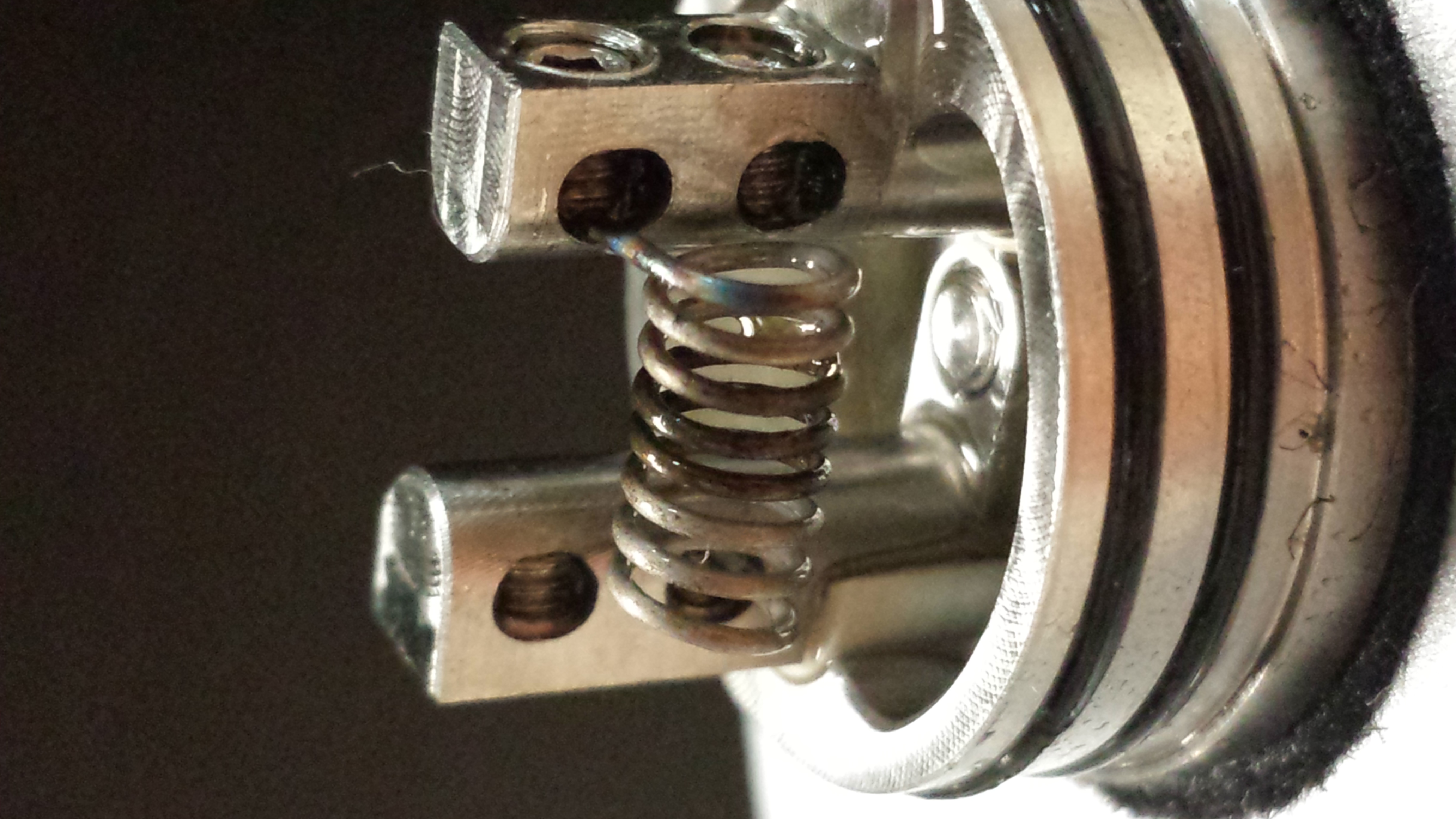

	  Titanium set up issues.RunsWithOtter replied to RunsWithOtter's topic in EScribe, Software and Firmware I pulled my cotton and it appears hot spots may be my issue. I'm burnt out from all the attempts I've made at this. I'll try again at another point. Also, sorry for triple posting. The mobile version won't allow me to edit my previous post. The Share/Reply buttons cover up the edit button.
	  Titanium set up issues.RunsWithOtter replied to RunsWithOtter's topic in EScribe, Software and Firmware Fresh built coil on my velocity. My previous attempts have been on my mutation, so I'm hoping this resolves my issues. Lightning Vapes Grade A1 Titanium, 24g 3mm 8wrap single coil. Came out to about .225 which is .015 off of what Steam said it should be. Made a CSV profile https://gyazo.com/60c3f8cce0dc9a20ce3fd5145e5381b2 Loaded it to my Escribe and uploaded the setting to my device. I also turned my preheat down to 100watts https://gyazo.com/2d2d672dbc13e49f4d813a74cb2b96a1 5 second puff 350 degrees, 65 watts. https://gyazo.com/354053544ff17f31f9058d804365e85a 5 second puff 450 degrees, 65 watts https://gyazo.com/dea3030a4d23017a0cda9bf6d7610d29 same setting, rejuiced my cotton. 5 second puff https://gyazo.com/32c42427e6d8cd86135a624add51144d It's safe to say I'm getting the same result off of my velocity as I am my Mutation.
	  Titanium set up issues.RunsWithOtter replied to RunsWithOtter's topic in EScribe, Software and Firmware Chunky - It's fine. Thanks for the post anyway. Haha 3dge - The coil is spaced. I may try snapping a picture of it and throwing that on the first post too. Nothing is shorting out on the edge of the well or the barrel either. I've tried 2 different builds that were slightly different and set up CSV files for them each time with the same result. If I turn my temp over 400 running 65 watts, it will not hit temp. Edit - I've done a little digging in forums, and the problem may be my atomizer. I'll try it on my velocity to see if I get a different result. I just wasn't ready to take the build out of it yet.
