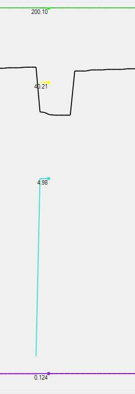

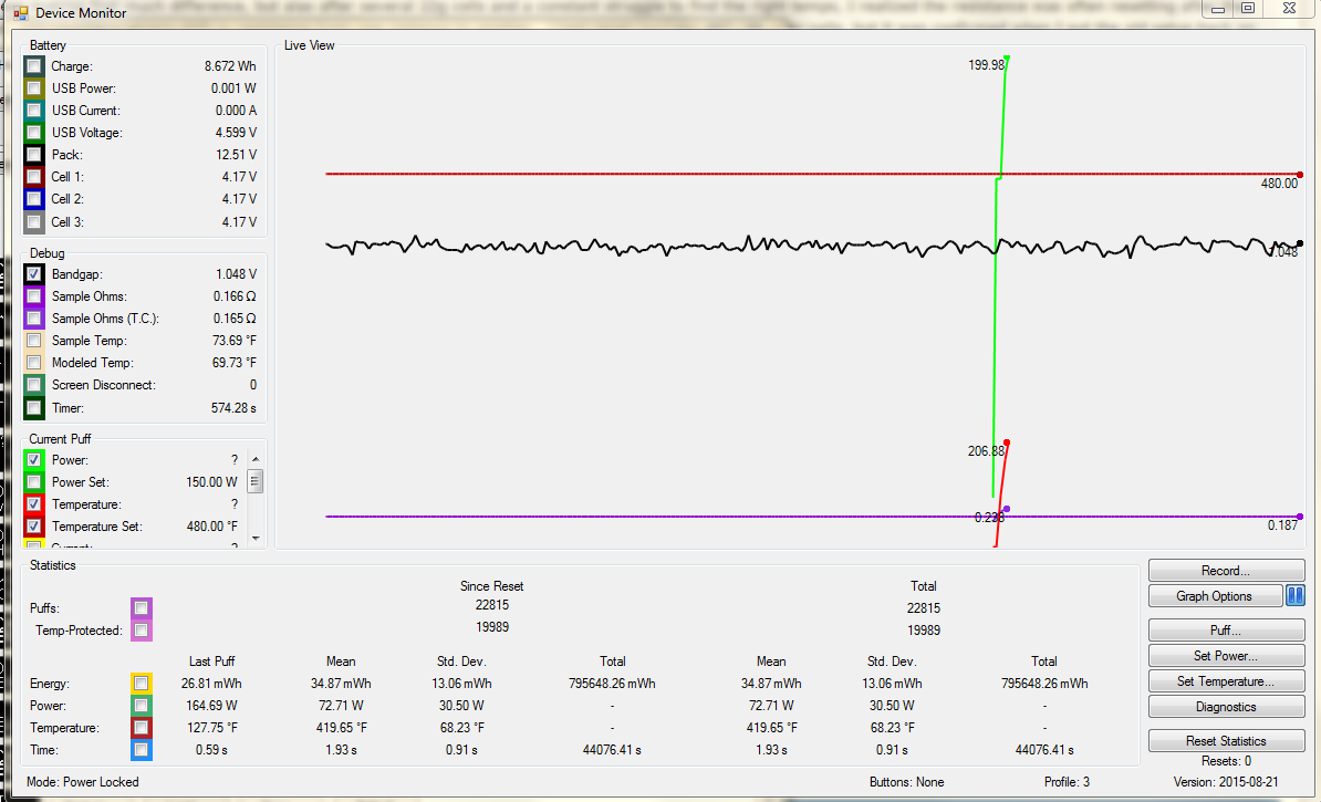

  4. It's strange... I had a rather long discussion with one of the other dna200 owners here in town and we were discussing 'true 200 watts' as far as 2 battery mods. I have been of the impression that 2 cell regulated mods were essentially incapable of keeping up a 200 watt output for any length of time. He did a basic voltage test at the atomizer and confirmed that an IPV3li was outputting less than the claimed voltage on the RDA. However as a followup, he also did the test, same RDA with the DNA200 and received nearly the same result. Here's a copy of the post.

  6. It's in that 1v range but should it be pulsing this much? Well answered my own question, looks pretty much like the Reuleaux does as well, so guess that's fine. I'll open it back up tonight and see how the mount screws are.
