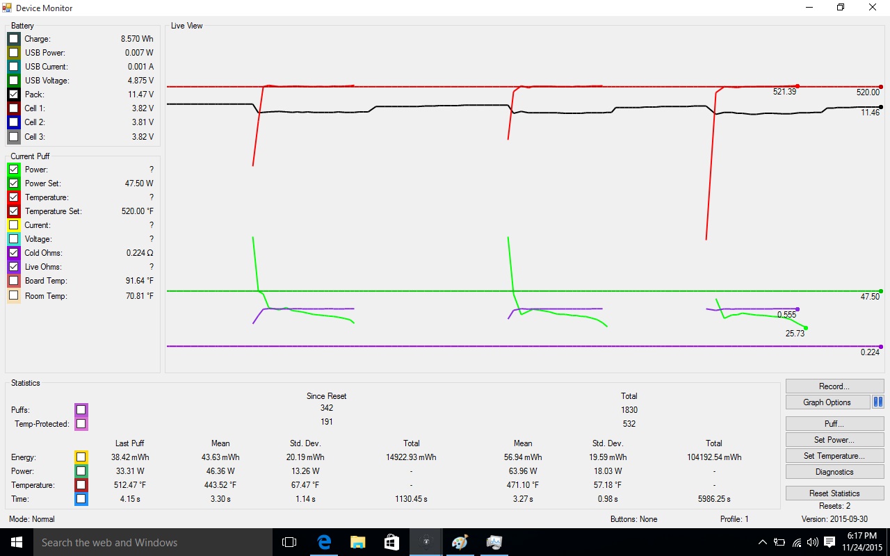

  4. Sorry bout that my phone went dumb. Wingsfan0310 what are your case thermals?
