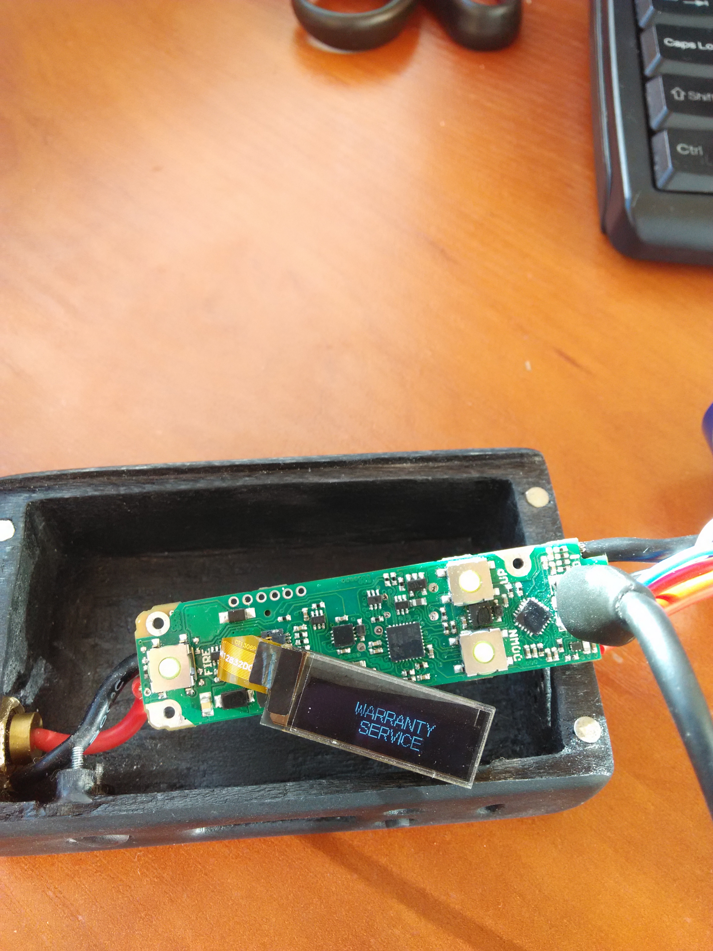

  3. Hi! I've finished my wooden box mod about a month ago. For two weeks, everything went perfectly. One day, when I've been vaping my Subtank mini with Ni200 coil on TC, suddenly vapor became too hot. And next moment my DNA200 stopped working. I checked the board and found out that the fuse had been blown, everything else in the mod and atomizer was ok. I ordered a new fuse Schurter, part number 3413.0332.22. And today replaced it. When I connected the battery to the board, the screen displayed the error message "Warranty Service". I'm very upset and disappointed. I'm without vaping for two weeks now and don't know how long I'll be.
