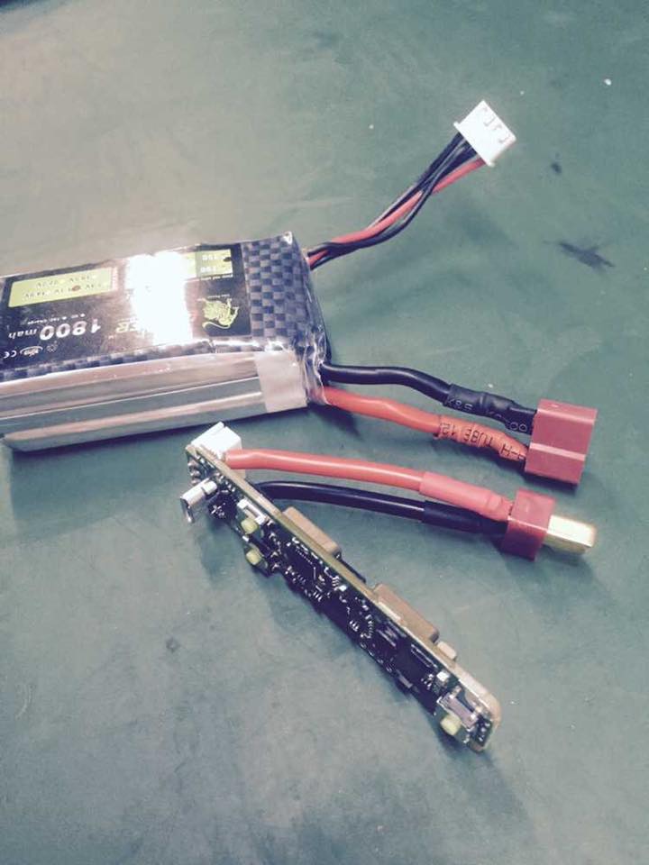

  6. Initial concerns about possible wire overheating in the top picture looked to be unfounded with some better pics in better light this morning. It looks like they deliberately melted the plastic and pushed the wire into the molten plastic to stop the wire wandering possible. The 510 is very close at that point. The wires to the battery cable. There are only three plus the strap and eyelet from the negative side of the battery cradle. There were then a thin black and a thin red wire which went to pins two and three of what would have been the lipo connector. A thicker red wire (the positive from the battery cradle) was connected where you would expect it to be on the board.
  7. Some more pics on the forum address from vapingbad above. It really looks like they melted a groove into the plastic and then pushed the wire into the molten plastic. The wire was stuck along the bottom surface of the wire insulation. As Vapingbad pointed out on the AAEC forum, that wire is pretty close to the 510 connector and while not an ideal way to secure the wire it was a practical solution to the possible problem. Some better quality pictures on that forum.
  8. I dont think it carries a lot of current, battery monitoring or charging maybe.
  9. I dont think so. Looks more likely that they have melted a channel there for the wire by the look of it, or a slip of the soldering iron. Maybe to stop it chafing or wandering somewhere where it shouldn`t be.

  19. Unfortunately you cant get two 1860 batteries to fit, not enough width in the cavity and there doesn`t seem to be enough scope to mill it out etc @dwcraig1 The cavity is only 33mm wide. I`m not a battery expert, but don`t you need 11Volts for the DNA200?
  20. It`s a bit odd, the company that make the batteries do not market another 1800mah lipo, but they do market a 1500mah battery which appears to be the same dimensions I have the mark 1 with the isuues, but easily fixed. The battery life does seem to be pretty low. It works very well and the colour/design does grow on you (red/black). The finish is great quality apart from the massive logo.
  21. Hi, I charge it through the USB, I dont have a lot of experience of Lipos although I am thinking of getting a balanced charger for when I have spare batteries for the mod. The 1800mah claim is very suspicious, there is not one picture or listing for that lipo anywhere on the web that I can find. There is a 1500mah one available which seems to have the same dimensions though I should add that anyone that has a serial number lower than 0200 should return it to the vender for a replacement to the safe version.
