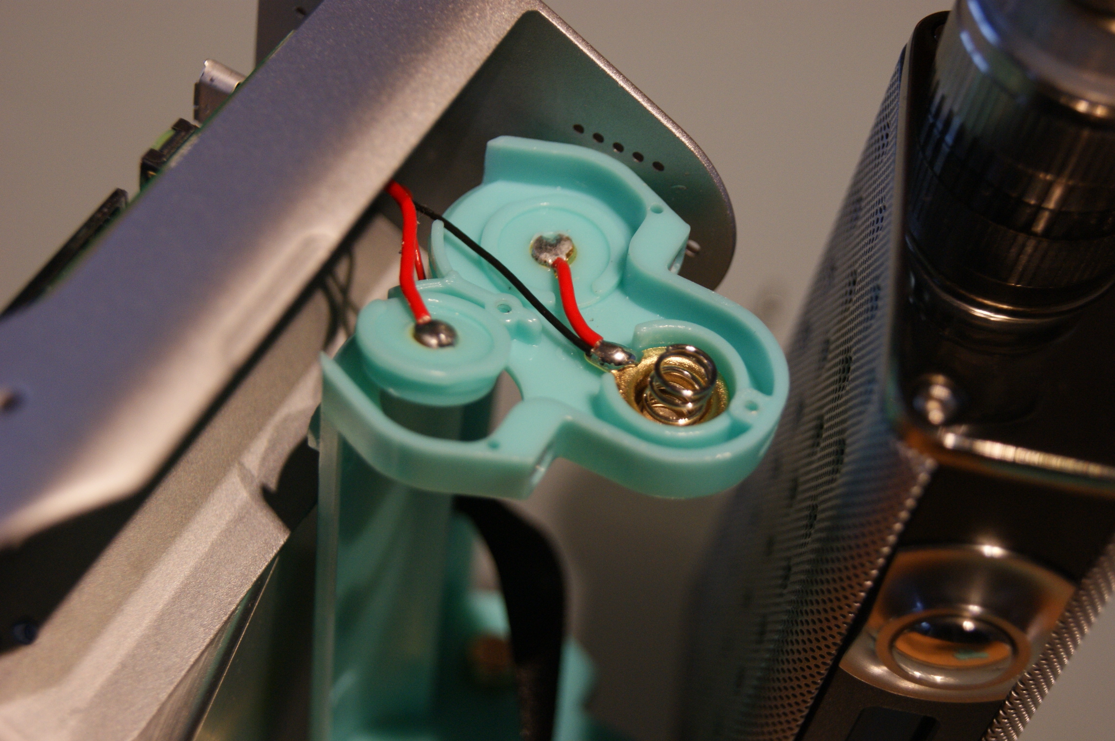

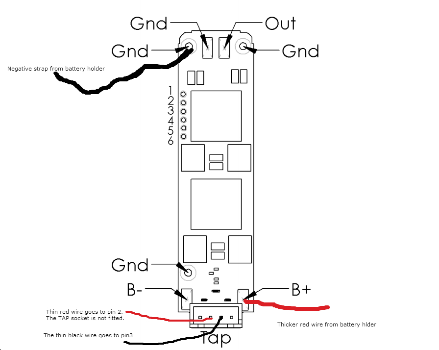

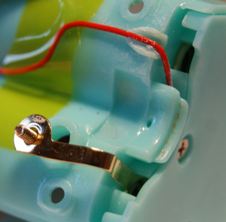

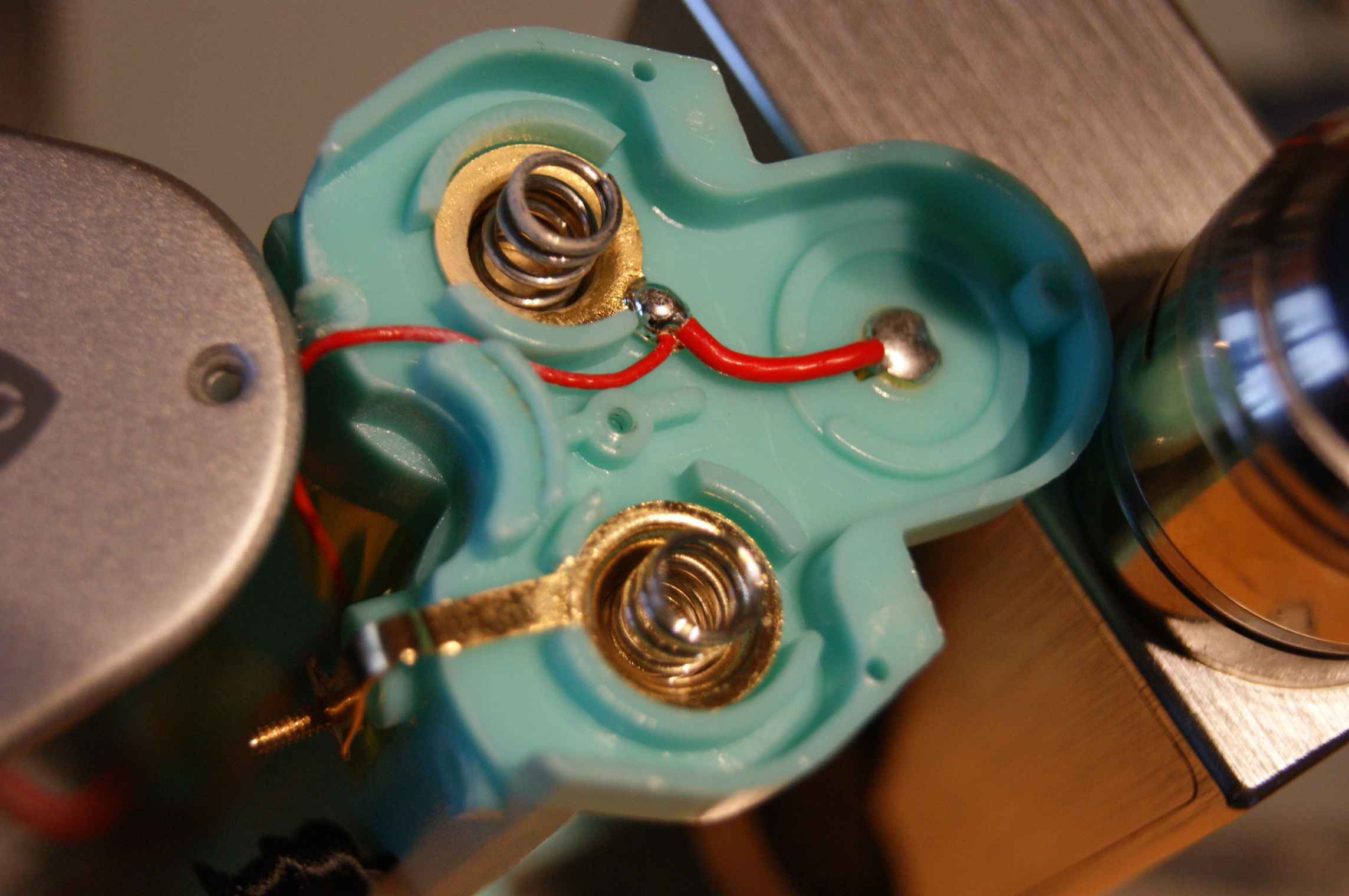

Initial concerns about possible wire overheating in the top picture looked to be unfounded with some better pics in better light this morning. It looks like they deliberately melted the plastic and pushed the wire into the molten plastic to stop the wire wandering possible. The 510 is very close at that point. The wires to the battery cable. There are only three plus the strap and eyelet from the negative side of the battery cradle. There were then a thin black and a thin red wire which went to pins two and three of what would have been the lipo connector. A thicker red wire (the positive from the battery cradle) was connected where you would expect it to be on the board.
Some more pics on the forum address from vapingbad above. It really looks like they melted a groove into the plastic and then pushed the wire into the molten plastic. The wire was stuck along the bottom surface of the wire insulation. As Vapingbad pointed out on the AAEC forum, that wire is pretty close to the 510 connector and while not an ideal way to secure the wire it was a practical solution to the possible problem. Some better quality pictures on that forum.
I dont think it carries a lot of current, battery monitoring or charging maybe.
I dont think so. Looks more likely that they have melted a channel there for the wire by the look of it, or a slip of the soldering iron. Maybe to stop it chafing or wandering somewhere where it shouldn`t be.

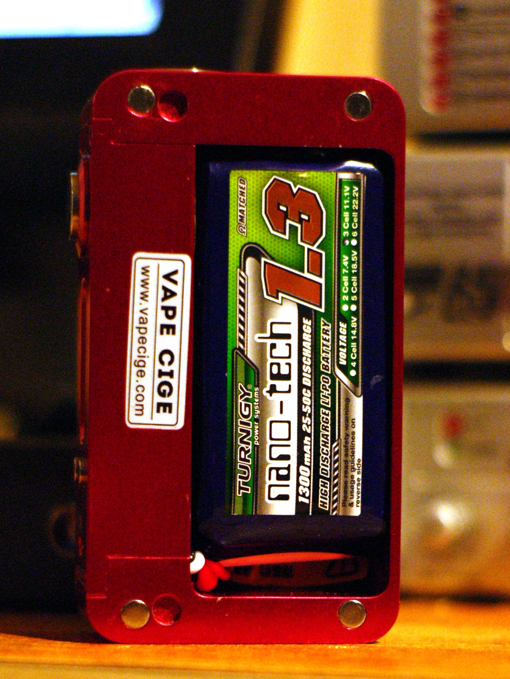

A big improvement in the battery performance from fitting the Turnigy Nano-Tech 1300mah Lipo. From just under a days vaping to just under a day and a half. This from a battery rated at 1300mah replacing a Lion Power 1800mah battery. Either Lion Power or Vapecige or both pulling a fast one. I am only up to first recharge on the battery so hoping it will improve more after 5 or 6 cycles.
Hi guys, I have replaced my so called 1800mah Lionpower (pussycat) battery with the Turnigy nano Tech 1500mah. Into the second day after charging. Does anyone know what the soft cut off voltage is for this battery? thanks in advance
Received Turnigy nano-tech 1300mah today and fitted, it`s a bit longer than the original Lion Power (supposed to be 1800mah , but a better fit widthways than the original (not as tight), Charged up and vaping. Wii let you know when I have to recharge.
Good to hear Popeye I got a very apologetic letter from the seller overnight who had forgotten that I had upgraded to a 3s version and paid for it, so should have it tomorrow or the day after
I ordered a 3s Turnigy nano Tech 1300mah battery and recieved a 2s battery, but I can confirm that the fit is excellent, even allowing for the third cell. The battery is covered very neatly with good square sides all round. It`s a good fit but not a tight one. Certainly not as tight as the original crappy battery is. Will post again when I receive the right one.
