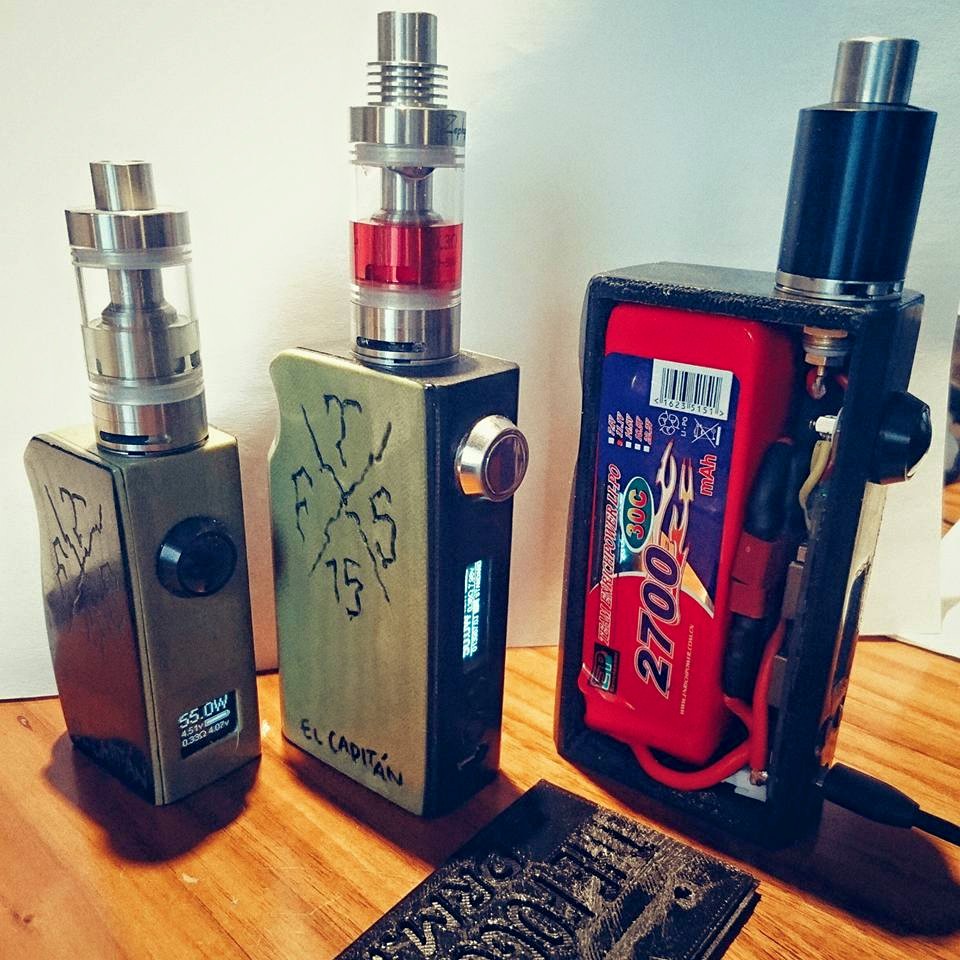

  3. So, I made myself a prototype. Or, I have two in the making, but wanted a huge mod for long lasting batterylife. Bought a china made battery from the local RC-store, and the smallest 3S they had was 2700mah. Huge thing. Anyway, I´ve been using this for the last 24hours to see how long it takes to drain it with my ADV tank, at 55w and 0.37ohms. Twice since last charge, it has juped from 30-something percent and up to over 50%. Seems like it never drains, but right now it stays like it should and the percent goes down. Why is this, is this a bug or does it re-read the cells after a certain amount of voltagedrop? Here is the brick side-byside with my Single 18650 SX350 60w and the dual SX350J 150w:

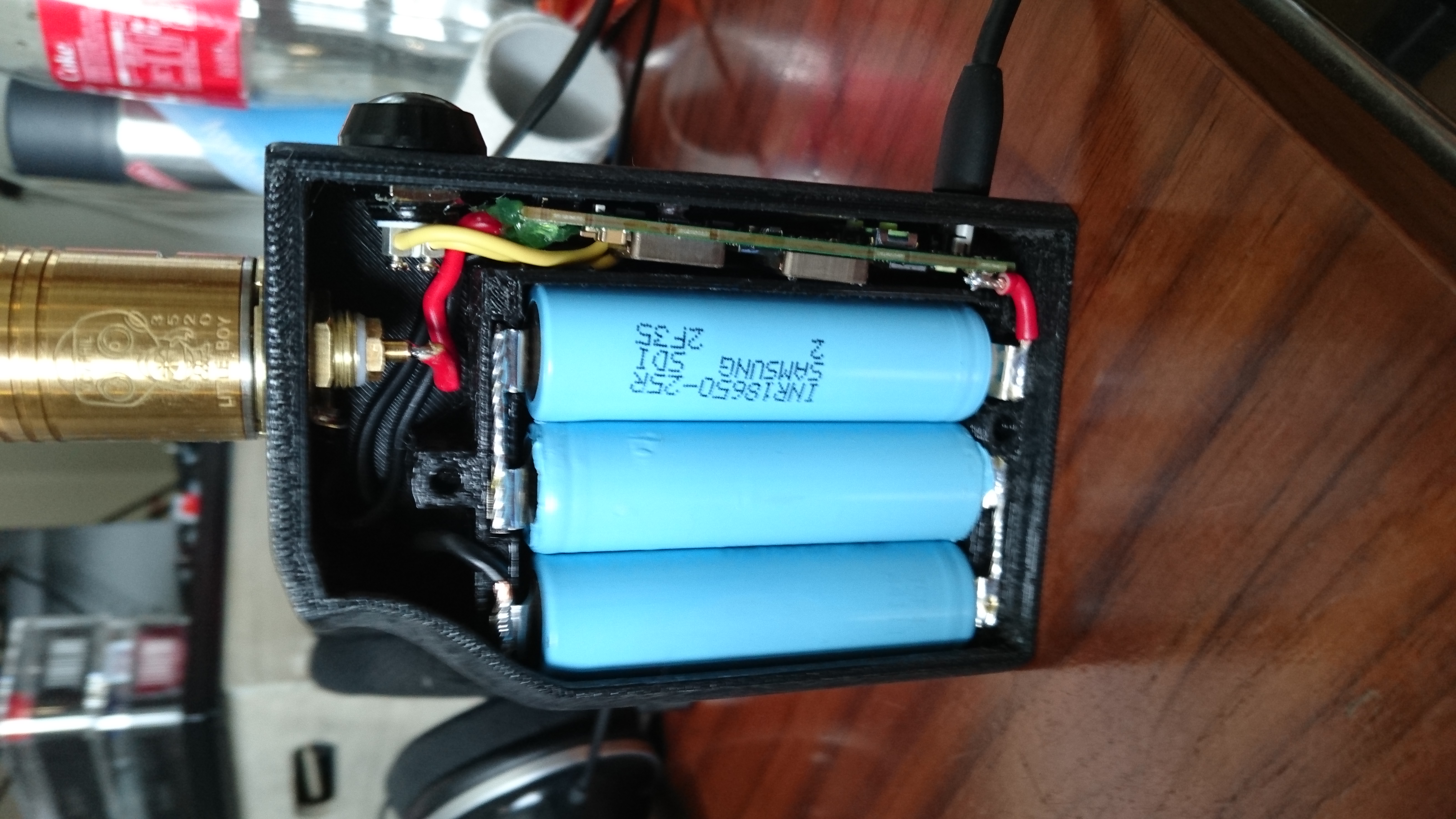

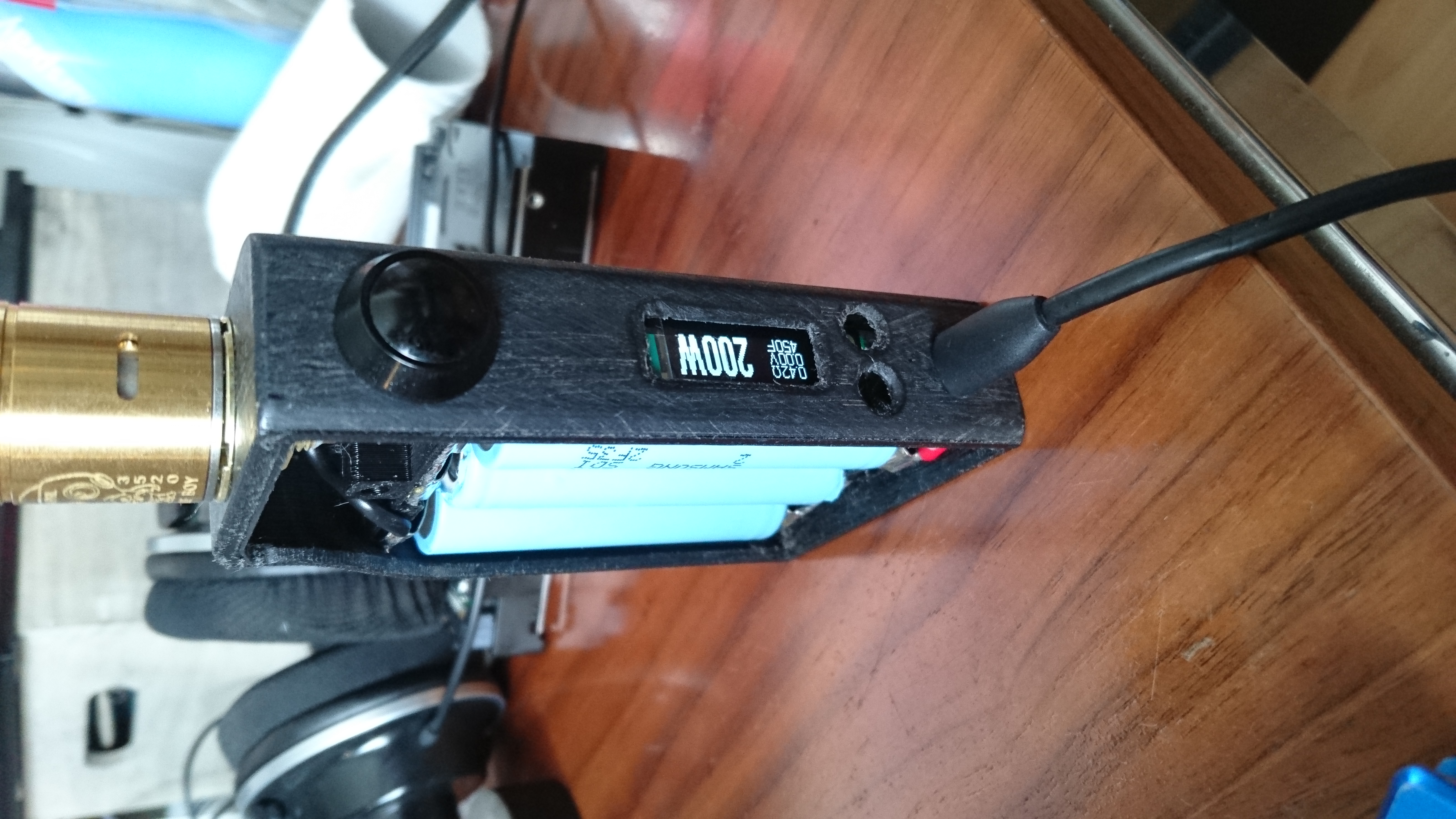

  13. So, I just got this chip and I´m making a prototype right now. But i wanted to use 18650s istead o LiPo, since all of my customers want long batterylife and the already use 18650s. Right now I can´t get the cell info as the LiPo provides, I´m not using USB for charging anyways. At first it didn´t work, but after changing to Mod>Power Supply it works, and I know it says to not use this with batteries. But it fires and it seems like it works. Any ideas here? And the display is flashing, cant find any settings for this and cant find the "error". Pics: Sorry for the Large phots and orientation, no time for editing here - The Foggin Sailor, Drammen, Norway.
