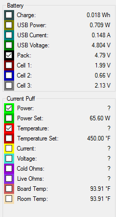

  1. i got it out and cleaned it after air drying i got it all put together and the mid cell is finally going up (pretty quick too) fingers crossed but I'm thinking the problem is solved as i haven't seen the warranty screen nor the check battery as has been the norm for me heres a screenshot Not quite out of the woods yet but this the best its been so far

  4. Update cell 2 is still at .68 and its been a while now / i wish something would let m know the recovery charge was active or not
  5. Yeah that is way off its 70 in my house and the box is cool to the touch ive seen people with the same problem just clean the board with iso but i have no idea how to get the board out OR IF I SHOULD i take electronics apart and fix them all the time but my mod is my baby Lol also I'm with the mod as we speak. there was a gu on this forum somewhere that had this issue and fixed it by cleaning a bit of juice off the board but like i said idk how it comes out and don't want do damage anything.
