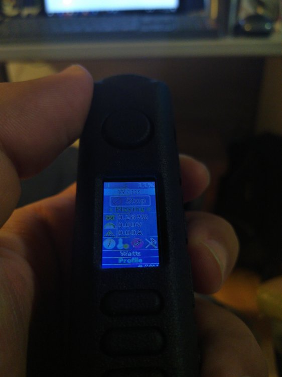

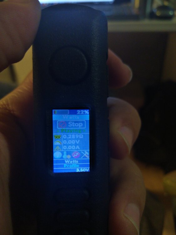

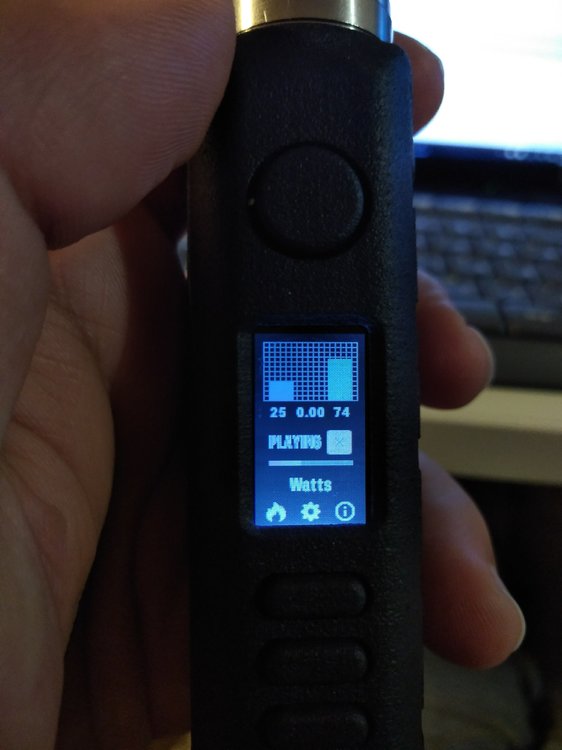

Thanks @retird I think it's the screen ribbon, it's very close to the fire button and it seems a bit squished. Here is another image of a popular theme that's not looking good on my mod. You can also see how if I shoot at an angle (from the top) it gets better and the text is readable.
I'm quite technical, if you have any ideas on how to troubleshoot, please share. I prefer getting a replacement screen rather than having to deal with the seller.
I already tried a few themes, and ended up using the one from Paranormal. The same issue existed on all themes. You can see how the white color looks black if you change the angle. The real colors are only visible if I'm looking from the top of the screen. Even when looking at the screen at 90 degrees the colors are way off.
The device is Rebel Vape, 21700/20700 single battery, non squonker.

I just got my first DNA75 color device this morning (I have a couple of DNA200s already) and I think I have an issue with the display. It seems that the viewing angle on my device is terrible. Does this look like a display/cable issue or is it more likely to be board related? I can change the screen myself if you think that's the issue. I don't want to send the mod back to the shop as shipping is expensive (21 pounds) and the guys at the shop are not the fastest out there... Any help would be appreciated.
P.S. On the images you can see the same screen shot from different angles.
