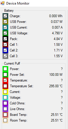

  1. Hey guys, Yesterday I was vaping no problem with my DOTBOX Dna200, I run a vape shop so Naturally I left my box on charge in the USB, for slow .5A charge over night as it rearly leaves the shop, Its either on charge by my computer or in my hand helping customers. This really is a spoilt mod. Anyway, I come to the shop this morning eager for some vape, to find battery 0% and not charging. Ran into escribe immediately to find this. Charge wH are 0 usb current should be .5A Really need to find the issue here. I have disconnected the battery and plugged it back in, I have also done a soft reset I am now going to do a Hard Reset. I have seen others with thise issue having a burnt out component on the board. If this is the Case, What can evolve do to help me as this device is only a month old now. Thanks in advance. Dale Foggas Vape Lounge
