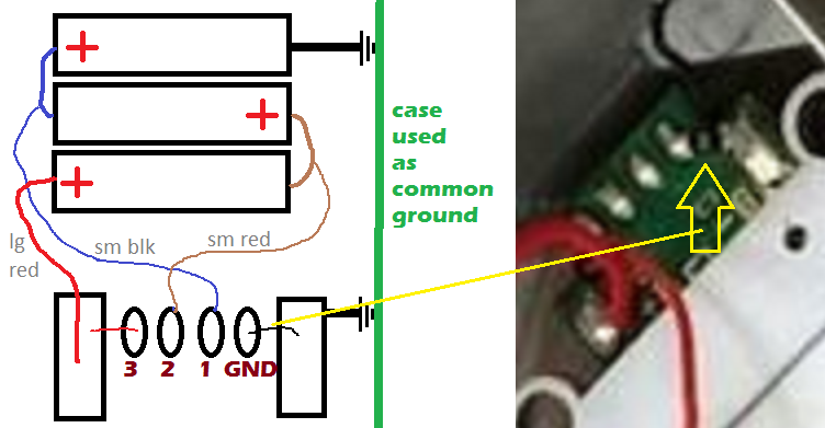

	  Wismec dna200 Reuleaux replacing boardalee132 replied to alee132's topic in Installation and Assembly I had my Reuleaux dna200 board go bad on me, it actually had one of the two large square inductor's come off the board completely. I sent it in and got a replacement board from Evolv, which btw as always they were a pleasure to work with and were great about doing the replacement. When I took this board out I noticed a couple things I didn't expect. First thing was the wiring seemed a bit small. Not the balance wiring but the battery wiring, the 510 wiring was large enough as well. Also it was wired strangely. Anyways, that's not what I want to know about. It had these two little square blocks, one of which was soldered between the B- and the balance ground solder point. The other was between then B+ and the balance point 1. I was able to remove the 2 little blocks and keep them. Although they are all black looking now and not sure how good they are but they still have the same shape. Anyways, I want to know what those little blocks are and if I should reuse them and wire it the same way? Or is there a better or different way of doing it? Also should I remove and replace the small wiring from the sled to the dna200 board? Will it make a difference in sag under load? Here is pic that I found on this forums posted by vaping bad in this post: /topic/67734-topic/
