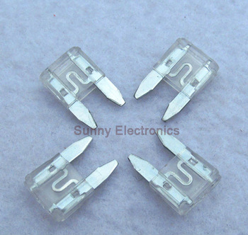

Please tell me if you are confident with the installation of automotive fuse, or not? because i have satisfied with your reply to this post. I prefers to install an automotive fuse because it (fuse blow) has been happen to my second device. I live in Pakistan and it takes more than 2 months for shipping and return from Evolv, due to the reason i am searching an alternate for changing the fuse. I have tried to buy the original fuse from: http://www.mouser.com/Search/ProductDetail.aspx?R=3413.0332.22virtualkey69300000virtualkey693-3413.0332.22 ebay and other vendors but they do not ship to Pakistan, therefore, i am searching for a good and authentic alternate. if there is someone who already have tried it and satisfied with its working, his opinion / experience would be very helpful for me as well as for others.[/QUOTE] It will work to fix the fuse, but if there is another problem that caused the original fuse to blow it will not fix that. Best to go be John and Jame's posts in this thread /topic/67186-topic/[/QUOTE] John Posted in the above-said thread referred by you as under: " If you are feeling feisty, you could short across the fuse on the board with a large wire and install a mini 25 amp automotive fuse in line with the battery if you have space in your device." What i understand, the Jhon's suggestion is absolutely according to the "wiring diagram" referred by you. Am i right?
People outside USA can buy cheap with free shipping from: http://www.aliexpress.com/item/2-pcs-lot-25A-32V-Car-Vehicle-Auto-Medium-Blade-ATO-Fuse-25-Amp-Automotive/2031841669.html?spm=2114.01020208.3.57.cEq34c&ws_ab_test=searchweb201556_9,searchweb201644_1_10001_10002_10005_301_10006_10003_10004_62,searchweb201560_1,searchweb1451318400_6151 Product Description Car Medium Blade ATO Fuses. Current Rating: 25 Amp. Voltage Rating: 32 Volt. Quantity: a lot of 2 pieces. Manufacturer: XC Electronics. 100% New, Never Used. RoHS Compliant.
Thanks for the reply......you may reply to this when u will be free. I have read and view the DNA200 data sheet portion relevant to "Fuse" is reproduced as under: Fuse Because of the energy and power stored in the battery, the DNA 200 includes an onboard 25 amp SMT fuse. The fuse is located on the underside of the PCB near the B+ battery terminal, and is labelled âFuseâ In normal operation the fuse should never blow. However, in the event of an error or short circuit on the board, the fuse will protect the battery. Should it need to be replaced, the fuse is manufactured by Schurter , part number 3413.0332.22 Replacement is accomplished by de-soldering the blown fuse from the board and soldering on a new fuse. No i dont know, i even dont know what are the general reasons of blowing the fuse. I have found a automotive fuse with an online vendor, which is described as: Features: Fuse Current Rating: 25A Voltage Rating DC:32V Picture: Will it work ??????????????? [/QUOTE]there's a few people here in the forum that have used automotive blade fuses. they do work. just make sure it's no more than 25 amp rating. but your best bet, if your board is under warranty, have evolv replace the fuse for you. [/QUOTE] Can you refer any picture / diagram of the wiring??
