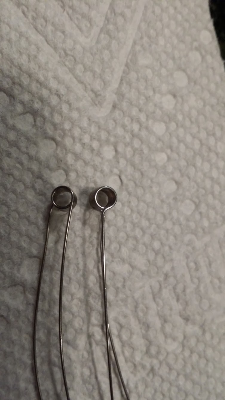

That's the 'problem' TC does only see the 'whole' coil(s) .. it looks for X% Ohm Change. The hottest parts of the coil(s) are the Legs and the Center. The right and left sides of the coil are cooler. Try it without Preheat. As you've read, I prefer lower, e.g 24, gauge wire because of the dampening effects. If you want near perfect TC then I highly, as in with the exception of Platinum or TiPt, Titan Wires Grade 1 Titanium 24 gauge wire! 'IF' an RBA has either 1/2 Coils or longer legs then I recommend coils as pictured below (stupid fast examples, lol not my best work):
