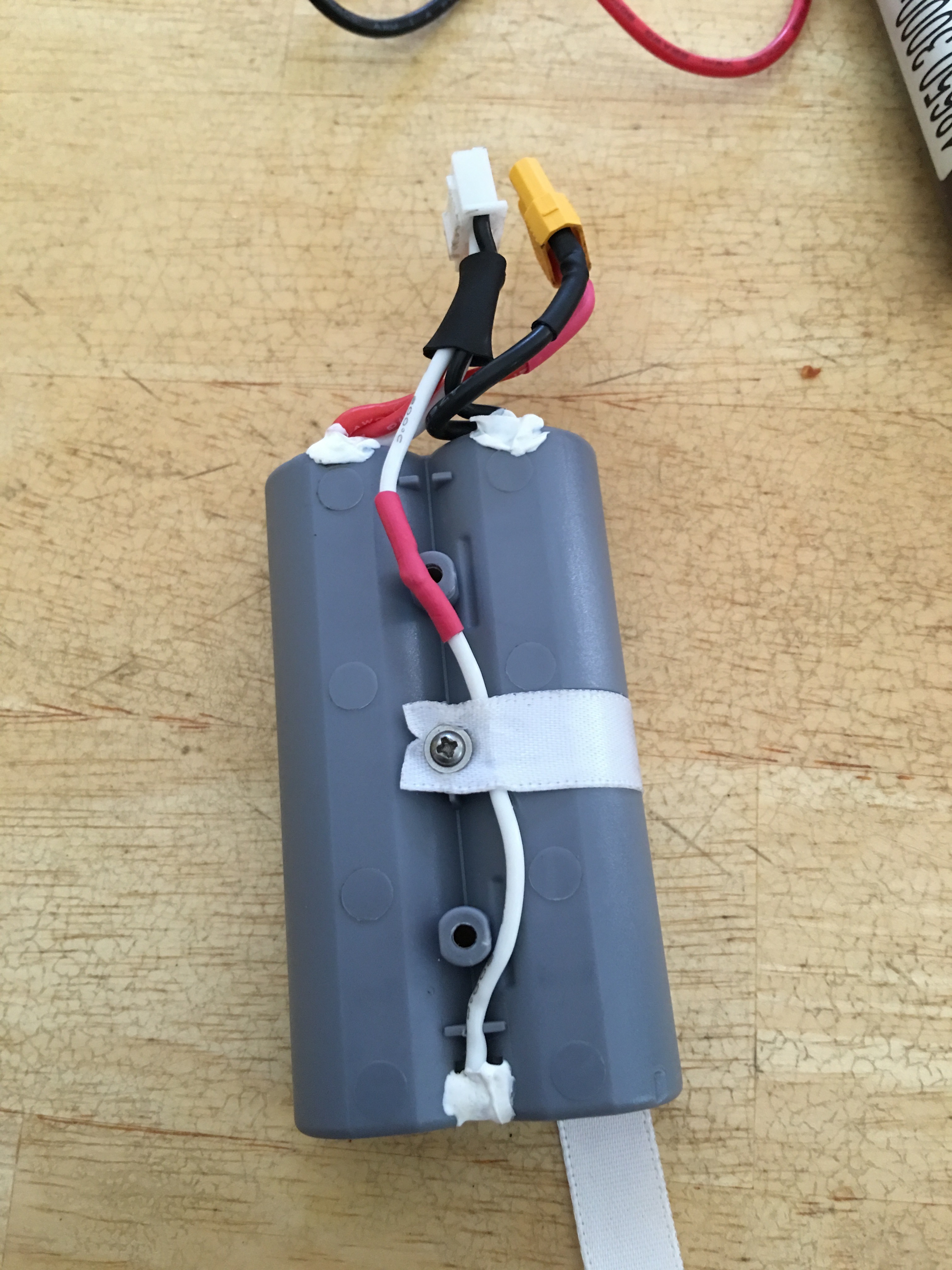

	  EFusion Duo - 2 LG HG2 - Imbalanced battery error {Solved}fredrogers replied to fredrogers's topic in Batteries and Charging Yes I did. Using the diagram you posted, thank you again , I checked all of the wires and the white wire is the weak link. It show an open from the pin to the sled. I am suspecting the splice you can see in in the pictures I posted. All of the other wires have good connection to where they need to go. -=fred=-

	  EFusion Duo - 2 LG HG2 - Imbalanced battery error {Solved}fredrogers replied to fredrogers's topic in Batteries and Charging Well I think I found it. Here is how I am labeling the JST for ease of reading: When I try to test for connectivity from the 3 pin (counting from left to right starting with the positive lead) to the connector plate at the bottom of the battery sled it is open. When I test with the batteries installed in the sled I get 8.4 on the main power leads and 8.4 on 1 and 4: But when I try 1 and 3 I get 0: I think the culprit may be a wire splice on the back of the sled: Or possibly the solder joint at the bottom. Assuming that is the issue, I just need to decide it I want to try my luck with a warranty or just repair it myself. But if there is something I am missing in my testing please let me know. Thanks! -=fred=-

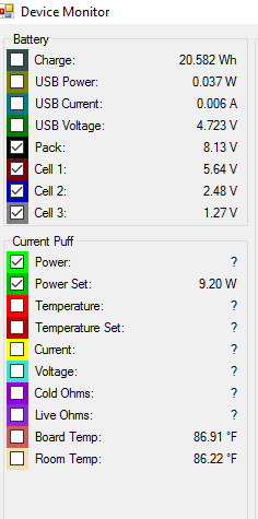

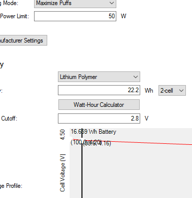

	  EFusion Duo - 2 LG HG2 - Imbalanced battery error {Solved}fredrogers replied to fredrogers's topic in Batteries and Charging Well I got home and tried again to get my EFusion Duo to use 2 18650s. I had the exact same experience. I tested the batteries with my multi-meter and they both read 4.21. I put the batteries in the sled and tested the voltage coming off the large red/black power leads: 8.41. I then put the sled in the mod and pulled up EScribe and changed the battery config under the Mod tab. I uploaded the settings then inserted the batteries and checked out the device monitor: I then tried to vape and the device "rebooted" again then the screen went dark. It would flash the welcome logo and then go black ever time I pressed the fire button. I plugged it back in to EScribe and did a soft reboot and opened up device monitor again: I am at a lost. I put back in the lipo pack, adjusted the battery settings back to 3 cell under Mod, and I am vaping like a champ. What do I need to do? Is it the board? The sled? The batteries? -=fred=-

	  EFusion Duo - 2 LG HG2 - Imbalanced battery error {Solved}fredrogers replied to fredrogers's topic in Batteries and Charging I finally got my Efusion in hand yesterday! I happily opened up the box, slapped in my married HG2s that were previously in use in a cuboid (though I never changed them in that device). Almost immediately I got imbalanced battery error coming up on the screen when I tried to vape my Russian 91 1.84 ohm at 8.5 watts. After a few more presses the device would "reboot?" and I would see the welcome screen again, then it would just go black. I then left the batteries out of the device for a few minutes and put them back it. I could power on the device, but got either the imbalanced error or check battery errors, then just flashing the welcome screen and turning off when i pressed the fire button. The batteries had been sitting around waiting for the Efusion to arrive so I thought they might have discharged a little bit. So I used my multi-meter to test them. They where within .02 volts of each other. So I tried my fresh off the charger pair, both read 4.21 with the meter, and got the same bad results. I am glad I also got the lipo pack. I pulled the battery sled out and put in the lipo. It was a tight fit. I hooked my device up to escribe, changed the battery settings to 3s and used the watt hour calculator to enter in 1300 mah capacity. Now it works like a champ! What is the best way to trouble shoot the 2 18650 configuration? Should I put the batteries in the sled and test the leads with my multi-meter? Can I use EScribe to ferret out the issues? Thanks! -=fred=- PS The EFusion is awesome! It weighs less with the lipo pack installed then my cuboid with out any batteries.
