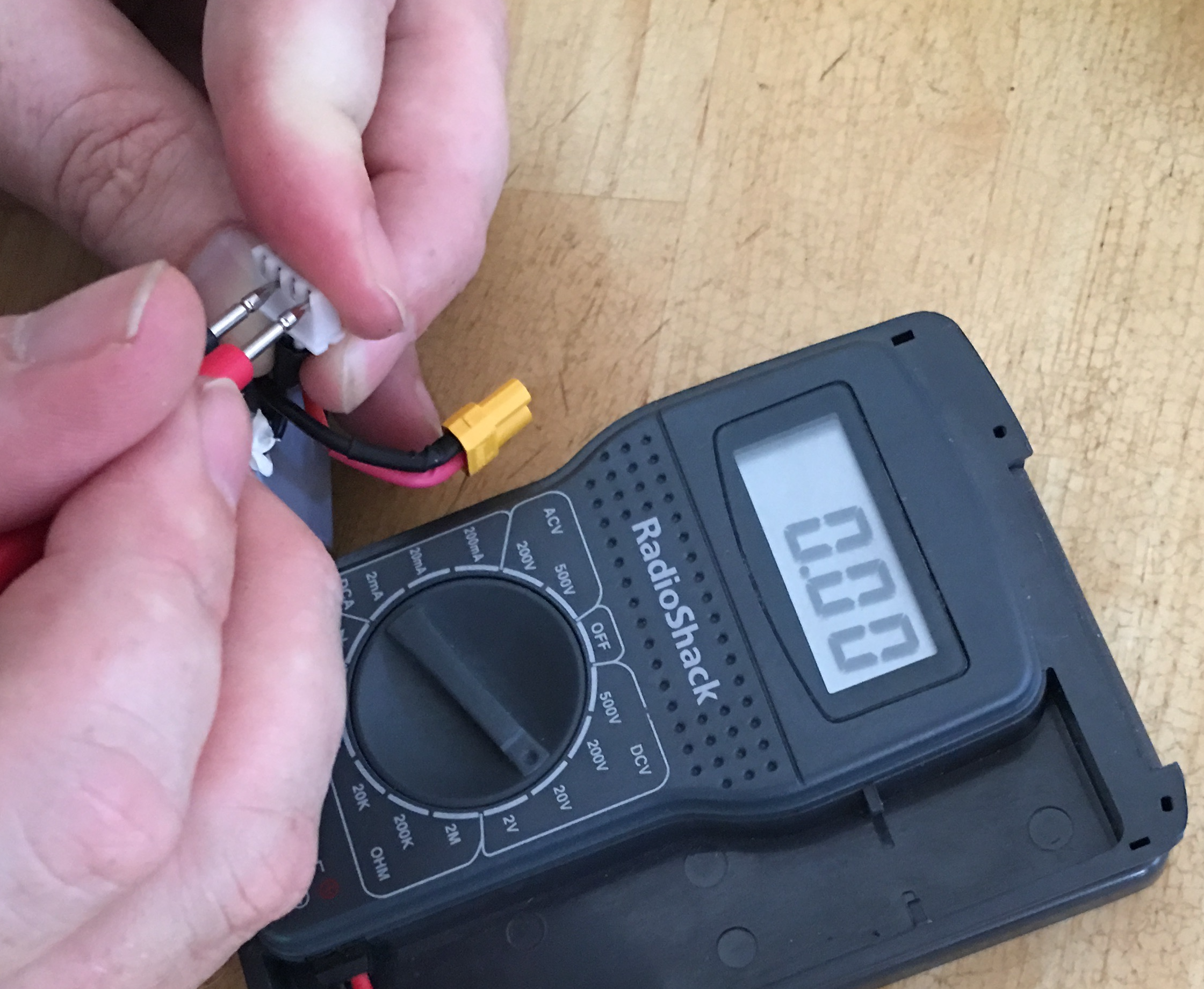

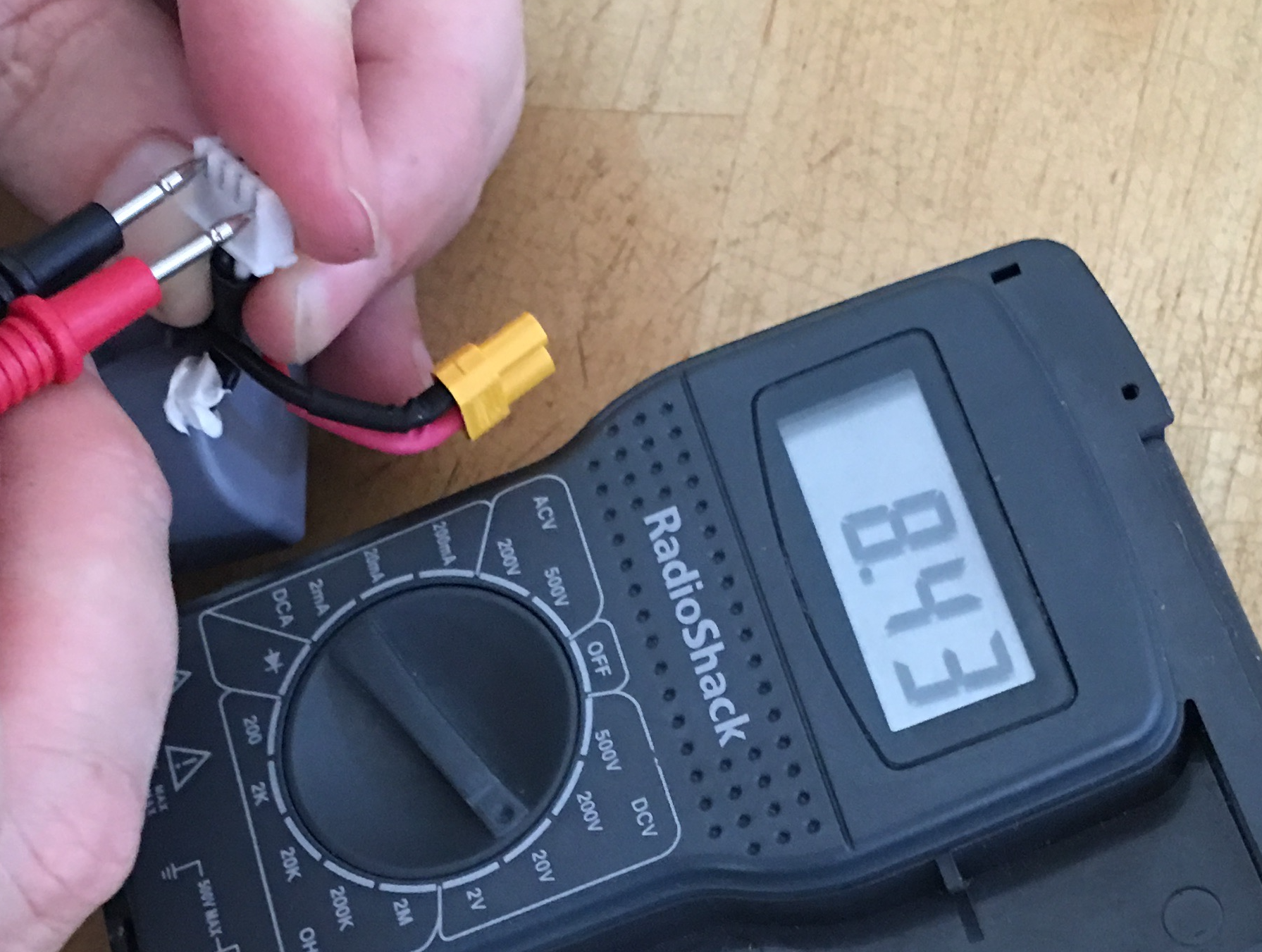

Well I think I found it. Here is how I am labeling the JST for ease of reading: When I try to test for connectivity from the 3 pin (counting from left to right starting with the positive lead) to the connector plate at the bottom of the battery sled it is open. When I test with the batteries installed in the sled I get 8.4 on the main power leads and 8.4 on 1 and 4: But when I try 1 and 3 I get 0: I think the culprit may be a wire splice on the back of the sled: Or possibly the solder joint at the bottom. Assuming that is the issue, I just need to decide it I want to try my luck with a warranty or just repair it myself. But if there is something I am missing in my testing please let me know. Thanks! -=fred=- -
