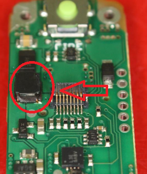

  1. Thanks I've submitted the ticket, I just hope I picked the right options.
  2. It boggles me, even without the battery installed on the board, plugging in to the USB that component overheats, Loaded up Escribe then plugged it in and that's what it did. PC didn't even recognize that there was a device installed and my usb ports are fine with all my other components. Not sure how to go about getting a RMA started or if it's eligible for one or not.
