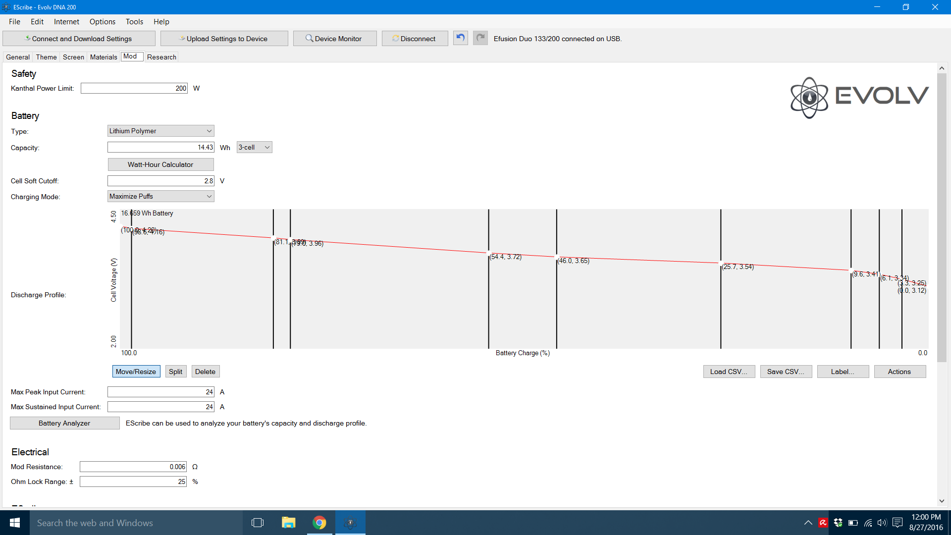

I just purchased an efusion duo. It was working fine for the past week in power mode. But today, when I went to change my 18650 batteries, it wouldn't turn on anymore. I tried multiple different batteries that all work in my other mods, so the batteries can't be the problem. When I plug the mod into my computer, it turns on. It just won't fire any atomizers. It won't even read any atomizers that work on my other mods, so it can't be the atomizers either. So I decided to switch to the Lipo. I followed the instructions exactly, changed all of the settings in Escribe as the instruction manual says to do. But when I unplug the mod and try to turn it on, it won't turn on. It will only turn on while plugged into the computer, but even then, will not read any atomizers but it is reading the battery and the Lipo appears to be healthy at 11.6v. and I did do the "upload settings to device" so thats not it either. This is what the mod tab looks like after changing to the Lipo. What could the problem be? Is there a way to fix this in Escribe? Anyone know what the problem may be? This mod was not cheap, and I'd hate for it to be bricked after only a week of use.
