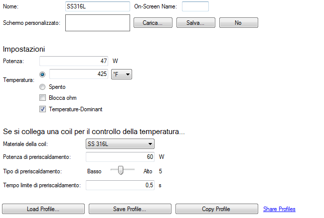

  1. Thank to everyone... it was a wrong material profile. i used "DNA200-SS_316L_DJaquith_V7" (attached to yoseff last message) to solve the problem.
  2. Lucaros5 thank you! I'll try later and I'll let you know if it works
  3. I've found that in the tab "Materials" clicking on the button "Actions" -> "TCR" there's a value of 0,006. Is that value correct?
  4. I've attached the screenshot... it's the default configuration given by lost vape
  5. Hi all I've a problem with my brand new mod (Therion BF by LostVape) with the DNA 75 board. It seems like it doesn't recognize the SS316L as TC material. In fact when I press the fire button the display show OFF instead of the temperature. I've the fw version 2016-06-05. Previously I had a DNA 200 board and it work like a charm with the same wire/material Anyone can help me?
