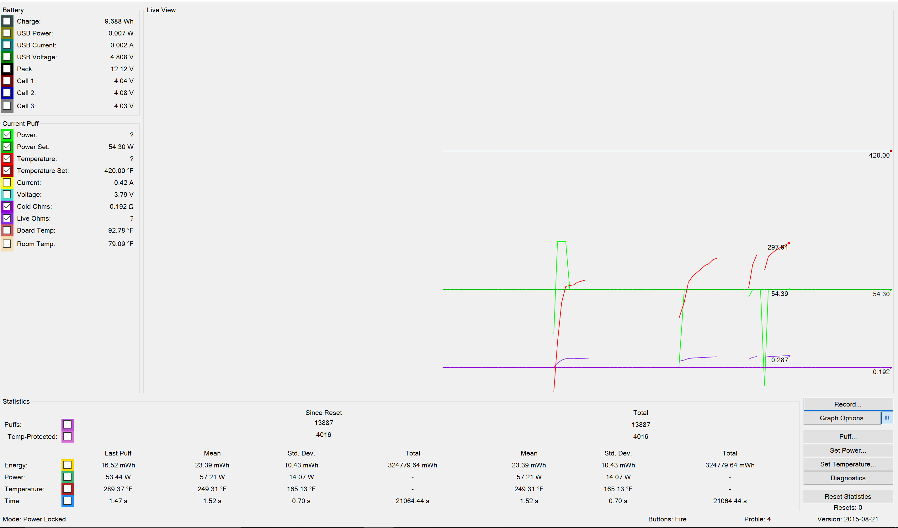

Ok, I did the dry wick test 100 watts 450F and it did not burn the cotton at all it worked as intended. After re-wicking and adding juice the TC stopped working... Ohms jumping around.
Yes I loaded the correct one and I'm on the right profile, I am certain. As of now my device won't use any type of TC and it thinks my Ti is kanthal. Do I need to add something to the "special" tab on Escribe?
I'm using sweet spot vapes .5 Ti wire (http://www.sweetspotvapors.com/product_p/tiw0.5.htm)
and I am using the corresponding CSV file for that sweet spot vapes wire.
My device seems to work with temp control, but when I fire my RDA with titanium it gets really hot and burnt like at 100-200°F so them temp control is almost pointless.
