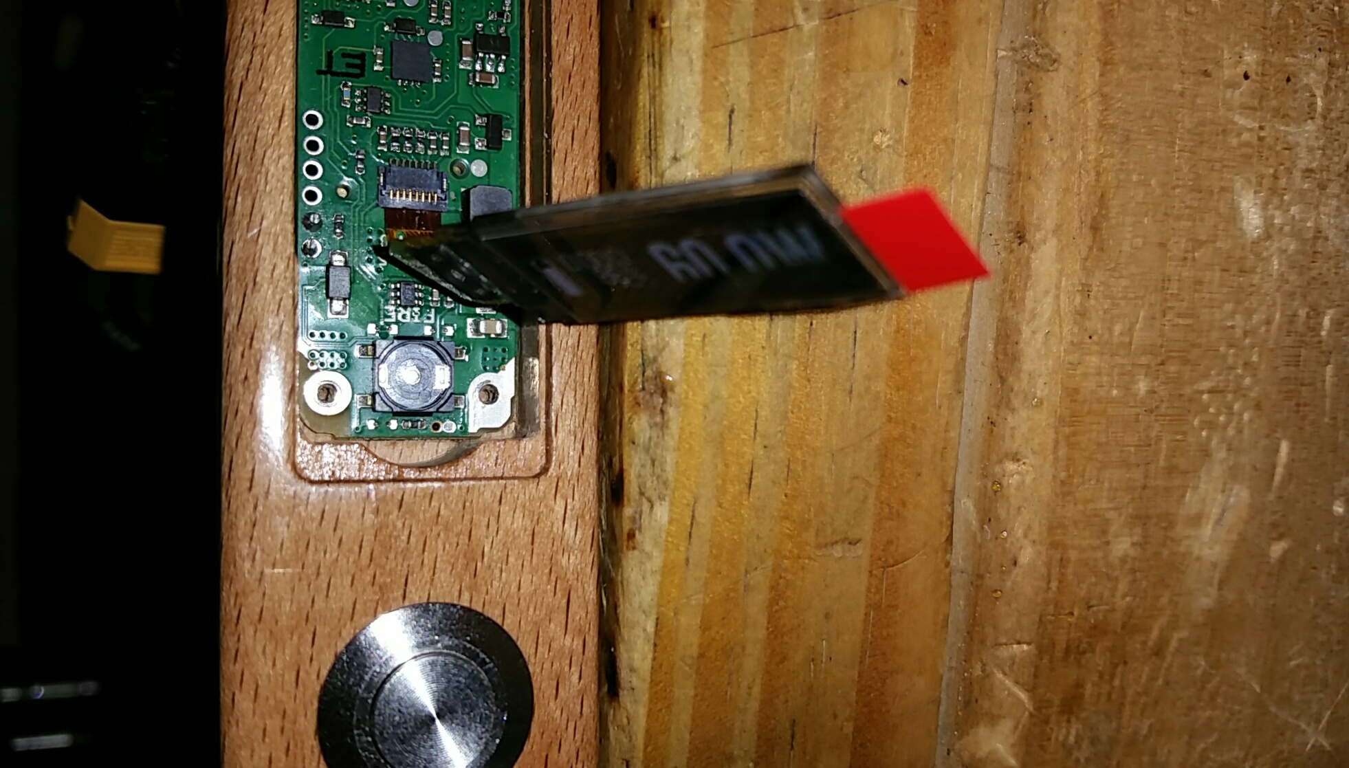

  3. This is another board I have tried to hookup an off board switch to and it autofired till the screen froze or more like the board locked up. Could it be latest firmware? It also does the same thing with just the usb connected and no battery.
  4. This is the 3rd time I changed wires.
  5. I have been having problems using remote fire switch on multiple boards. I have removed the inside of on board switches and used the 2 upper fire switch holes to go to Mitech fire switch using 24awg silicone wire. But every oard I hook up this way acts like it is firing by itself. Do I need to put 100 ohm resister on the pads under switch?

  10. I'm running out of patience 2 boards so far tonight. This one won't connect to computer or see the battery. Wood boxes so no shorts, re-flowed the solder on balance connector. I'm at a loss.
  11. At first when I installed battery in Mod it kept giving me Too Hot error even though it was first vape. Then it stopped that but its telling me in device mgr that it's 97 f in the room and the board is 98.2. it's just about 72 in the room really. And yes I reloaded firm ware and installed results from case analyzer.
