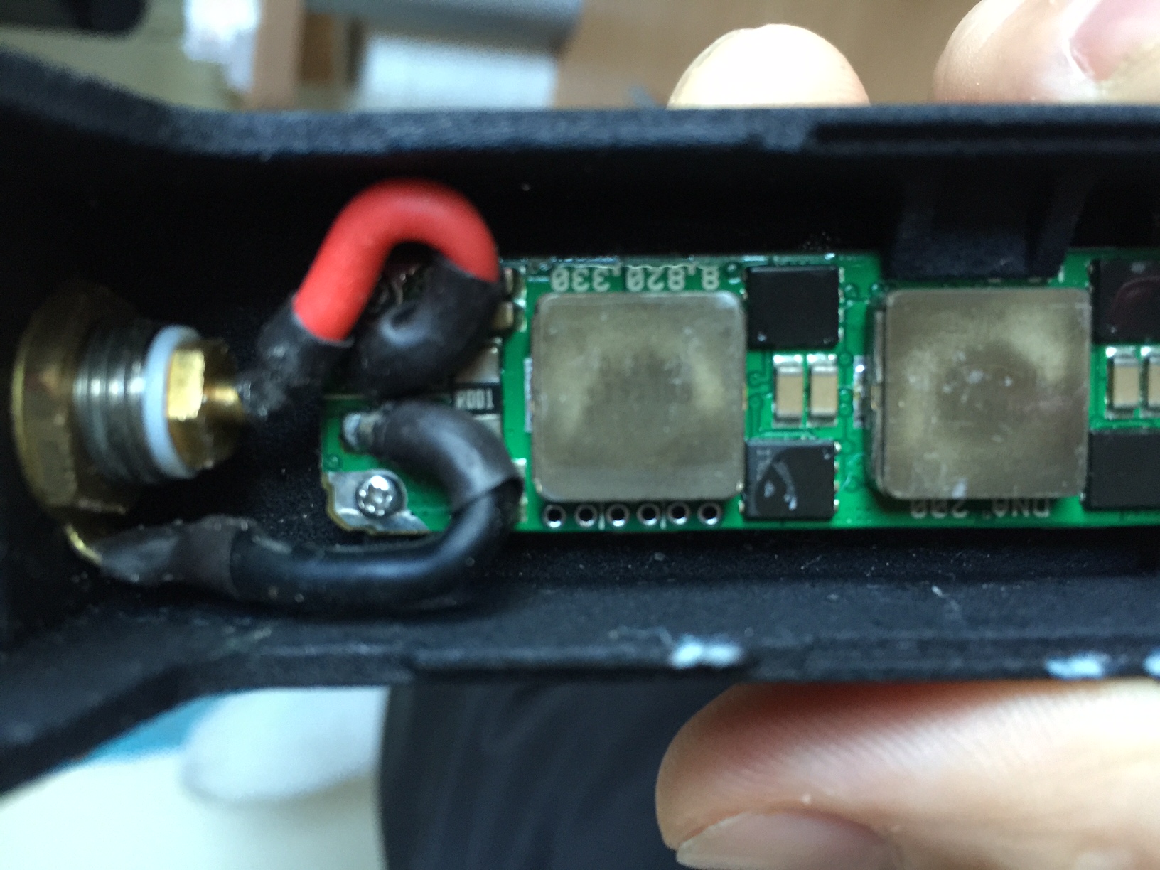

  6. [video]https://youtu.be/666xjdQjjng[/video] This video demonstrates the sparks that are produced across the 510 connection. Here is a photo of the internal 510 connections.

  9. Earlier today my replacement DNA 200 board blew its fuse. No obvious reason it has been operating as expected for about 1 month after the previous board quit. Since replacing the fuse I have been getting sparks across the 510 connector, I noticed this originally when I was testing the spring return center pin. My question is has the fuse blowing incident caused another issue ion the board? My lost vape efusion doesn't behave like this so I guess its RMA number 2. FYI it is a 3d printed enclosure and all solder joints have been checked reflowed and heat shrink wrapped after my last RMA experience.
