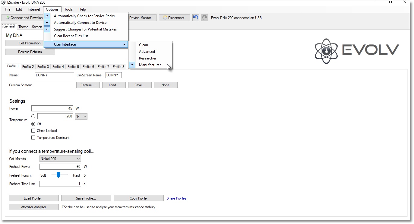

  2. Hi all, I do have the same problem today. It happen after i escribe my Finder 133. Almost desperate, but then i try to check the escribe software, then finally. You should Try to update the firmware of the mod to early update. Don't forget to backup all your settings before did the update. Then open the escribe software, choose Option -> User Interface -> Manufacturer. Ussually if we don't choose the User Interface, the default is Clean. Then choose Mod tab. You will see Battery option. Beside the Capacity text box, there is a drag option bar, the default is 3-cell. If you are using Finder 133 with 2-cells battery, as i am, then you have to change the value become 2-cells. Then click the Watt-hours calculator to get the capacity value. The variable is written in your battery. Fill the Capacity text box after you calculated it. Then upload the settings. Voila....you did it. hehe. If this can't solve your problems, maybe others have another way. Just share my thought. Btw, coba aja dulu mas. Siapa tau bisa. Karna saya juga berhasil. Thanks
