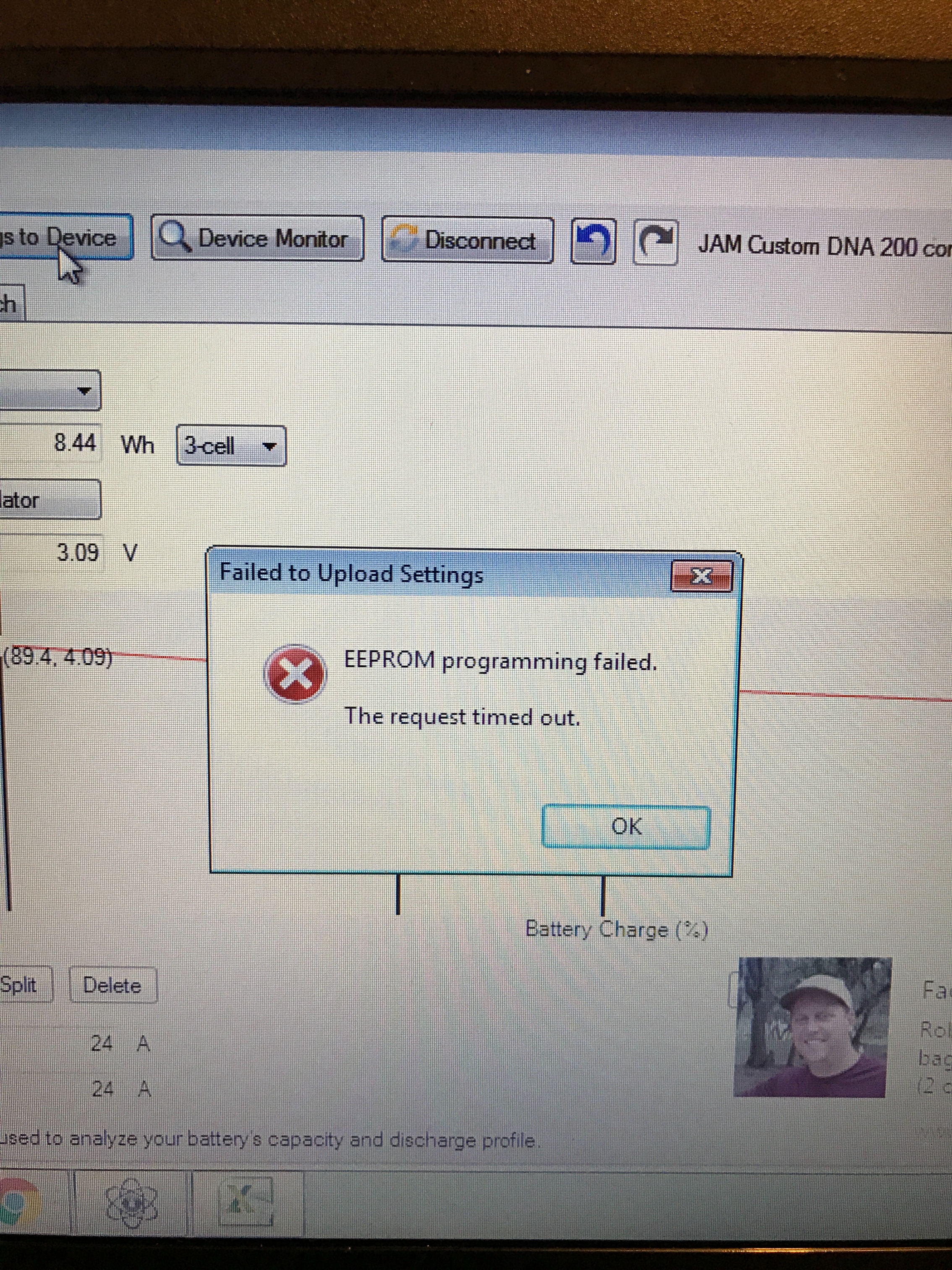

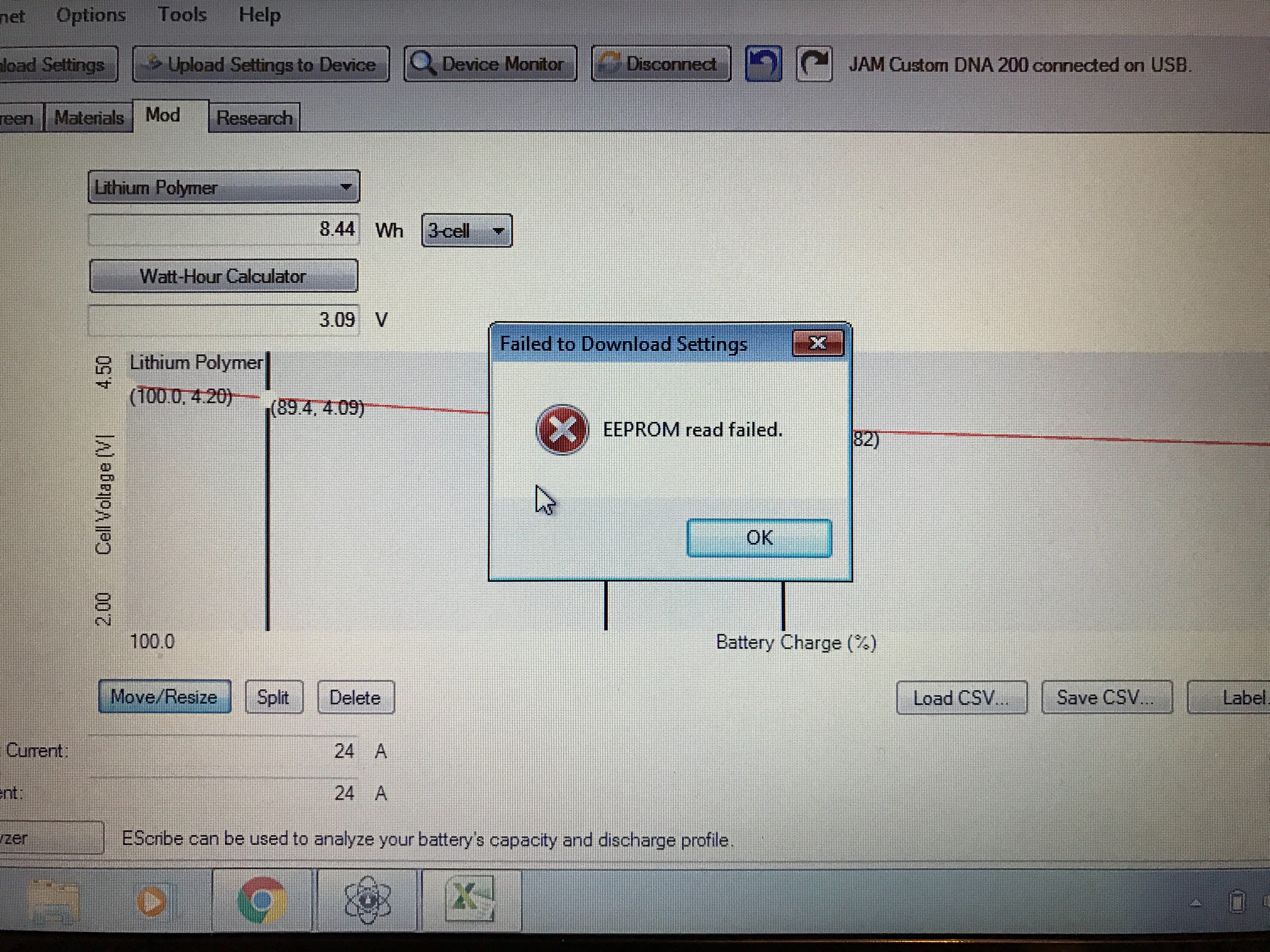

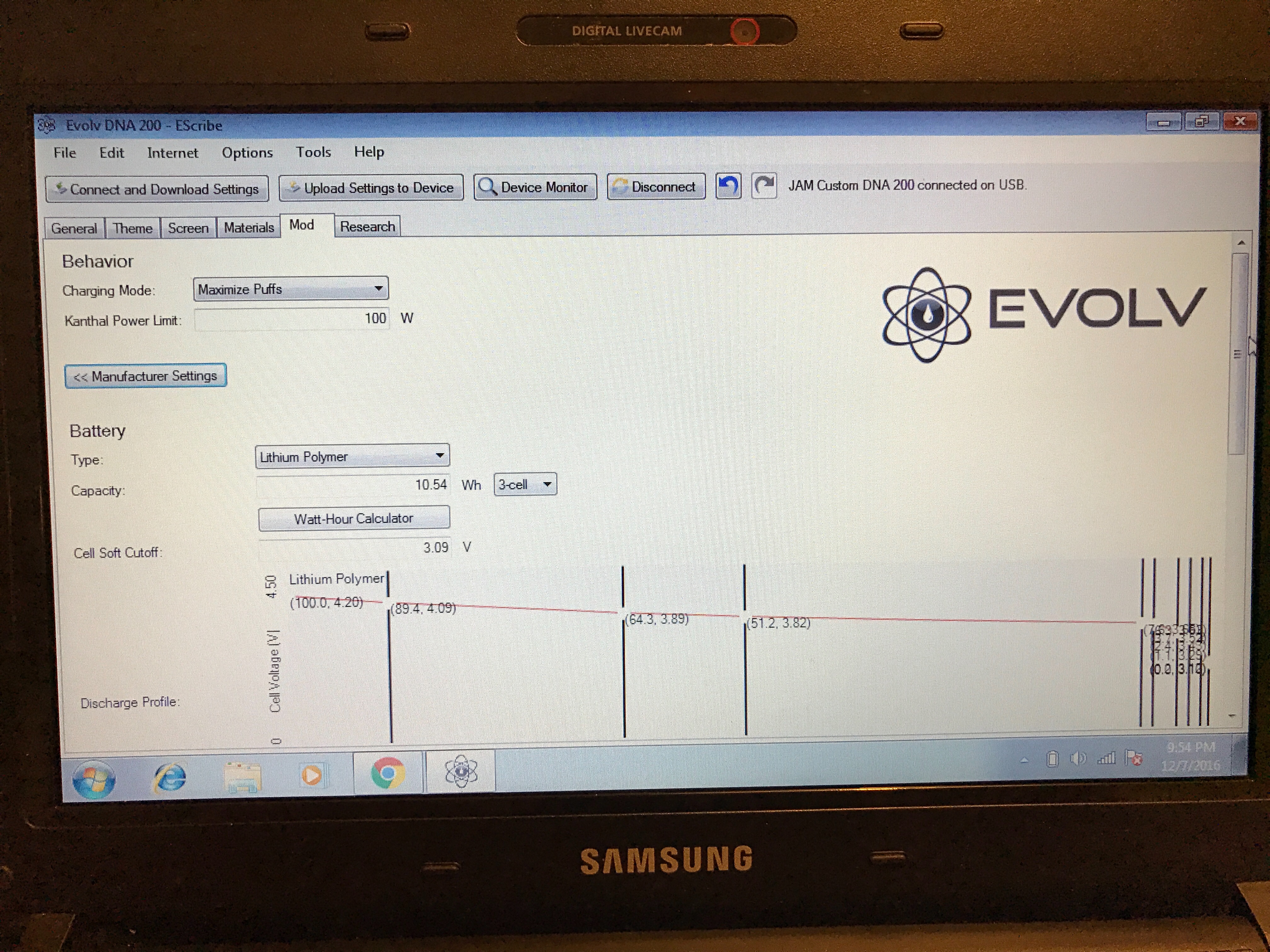

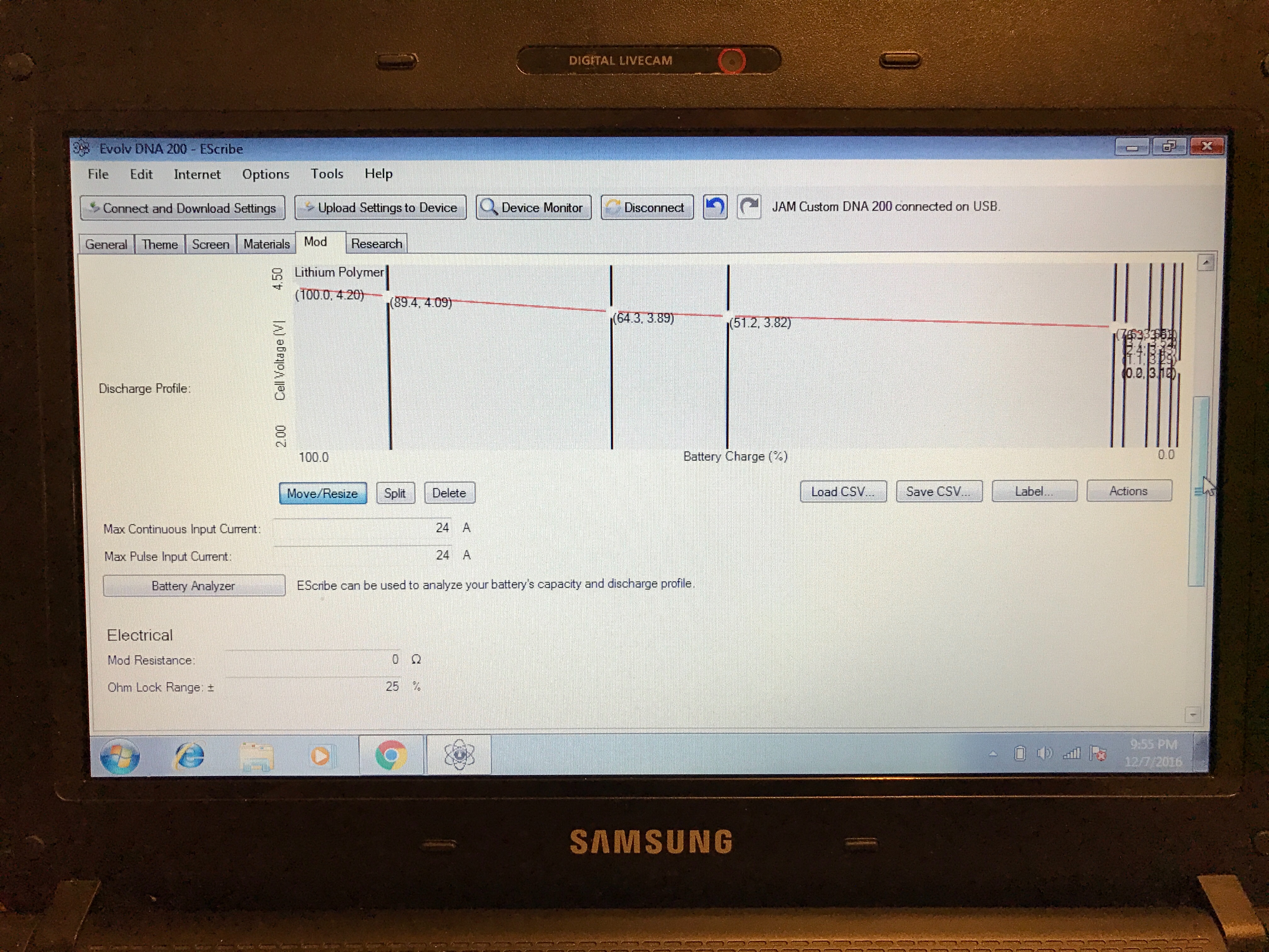

So, I tried loading a battery csv file for the battery I have installed, and it continuously failed, I then changed my Wh settings, went to upload the settings and now I'm having some issues. Getting these errors. Any ideas?

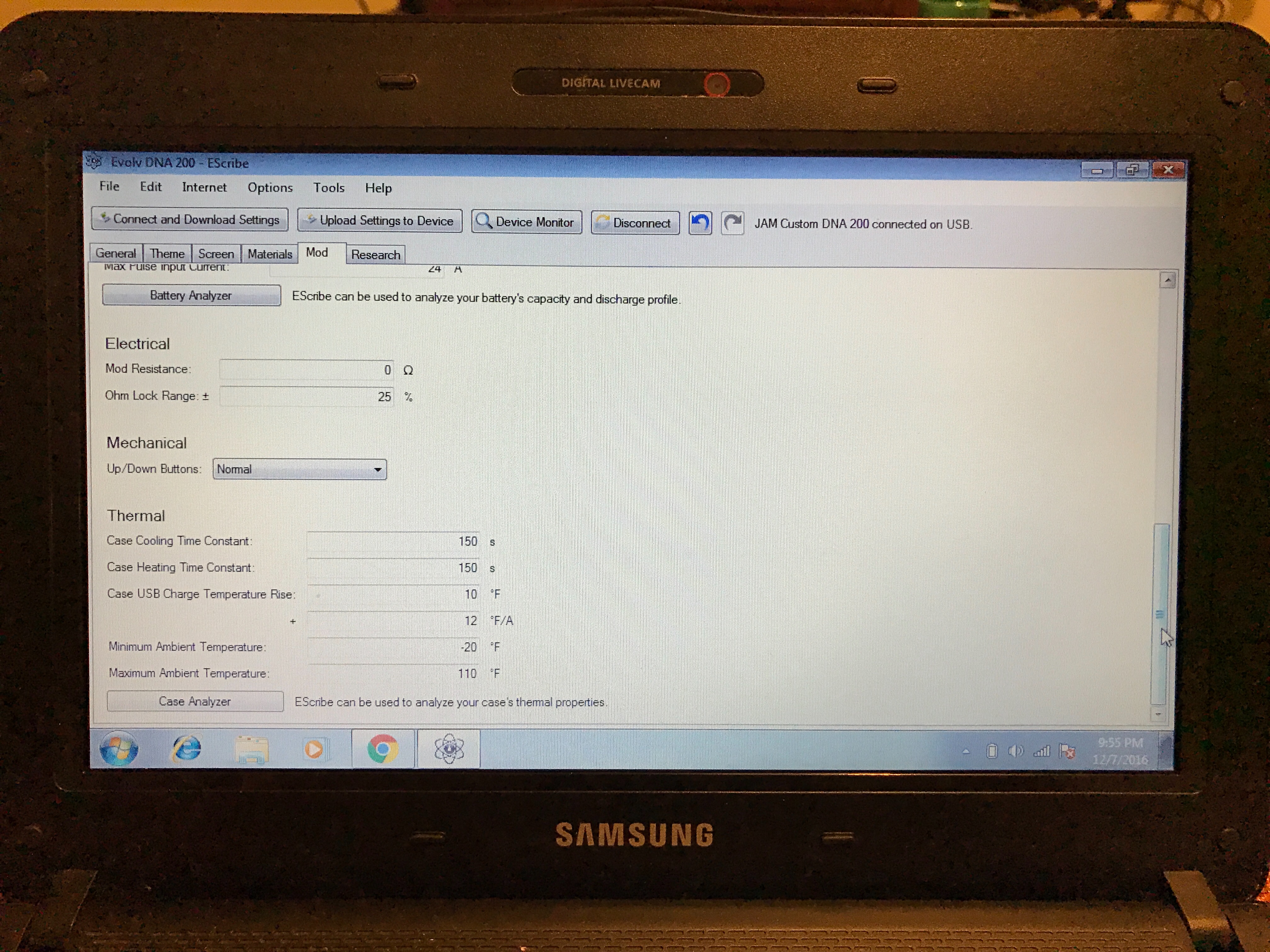

Thanks for the help, here are a few pictures from the Mod tab (sorry for the multiple pictures, I use a Mac normally so I use a crappy netbook for my Escribe lol). The only thing I changed when I hooked it up besides themes was the what hour calculator, I changed it from 1300mAh to 950mAh.
Got a question for the DNA gurus lurking around here. I have a homemade DNA200 mod with a 950 mAh lipo. Once my battery hits 19/20% life it will no longer fire up to the watts I have the device set at (currently 95w). Then, it would seem after letting it sit for an hour or so, once I power it back on the battery life reads at 0%. Everything else works wonderfully, it's just this issue when the battery gets low. I'm not sure if perhaps it's a safety setting in Escribe to keep the battery from getting too low but I'd like to have some idea of what's going on. Thanks!

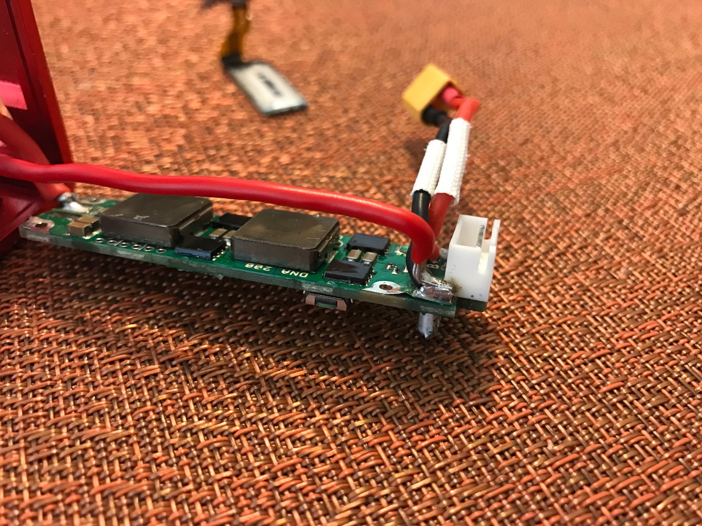

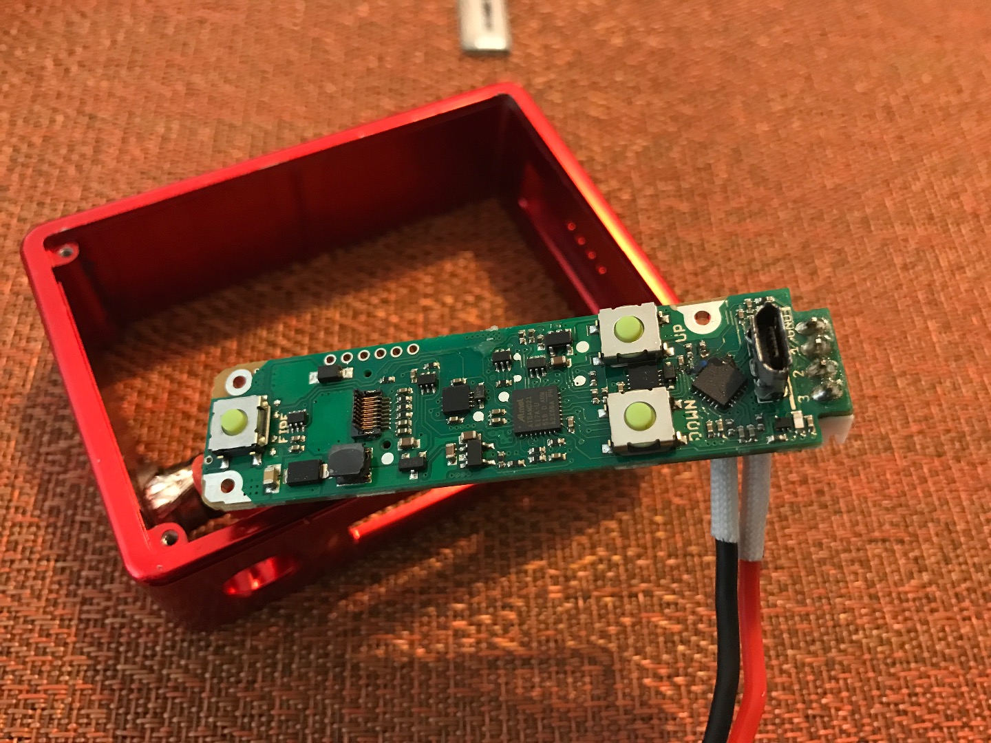

Yeah, I already have an open ticket, their initial response was that it sounds like a problem with the 510 wiring, which it isn't.

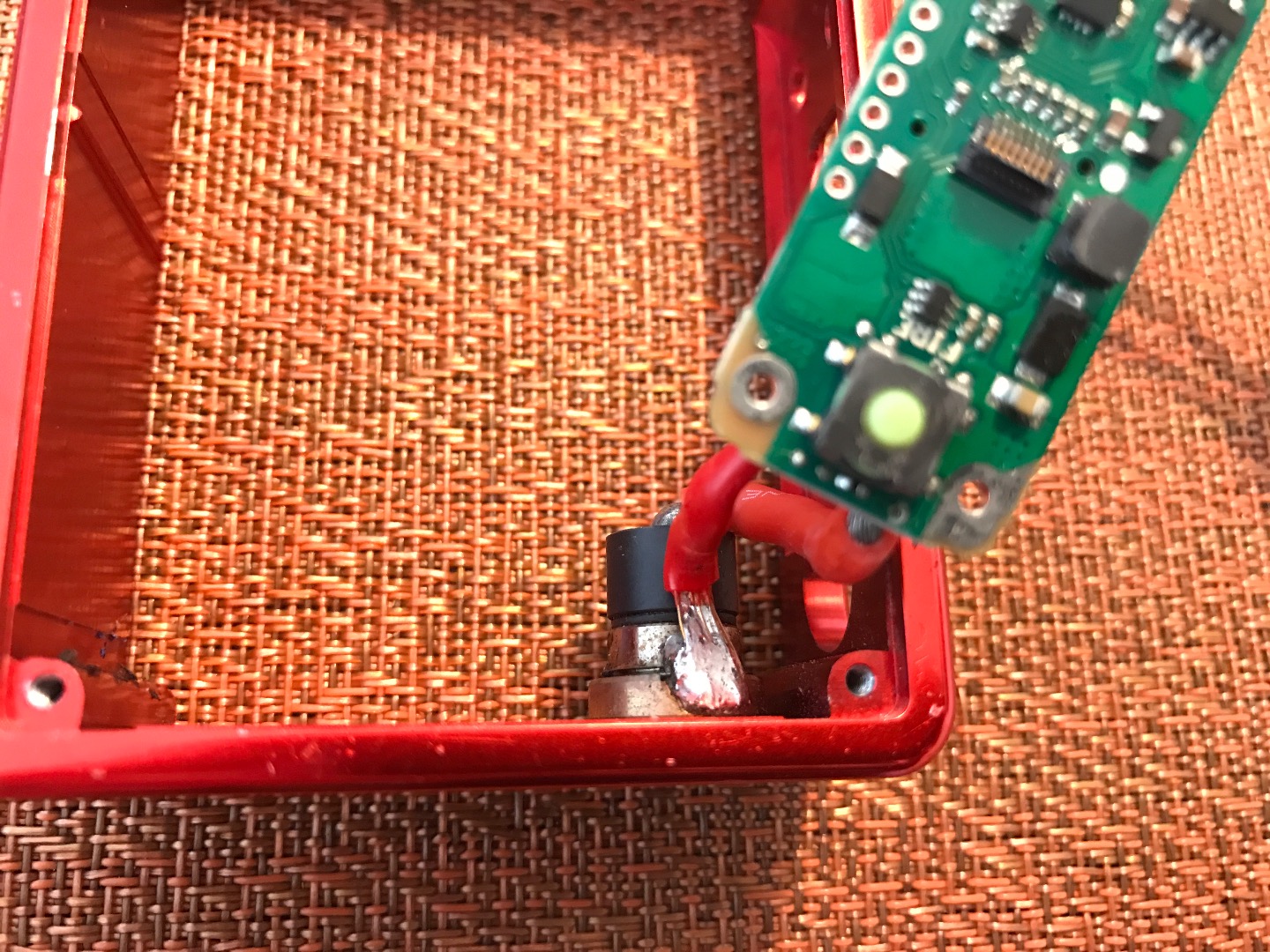

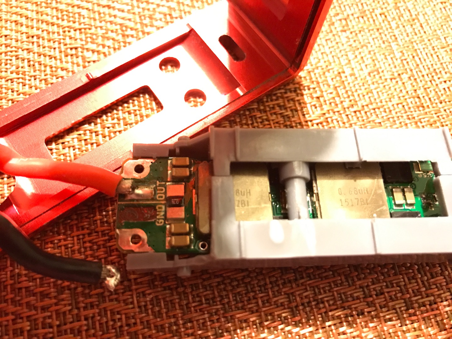

Yeah I understand what you were talking about, when I soldered that 510 wire on, the ground pad was still secure to the board and it was still not registering any kind of battery.
That pad lifted after the fact. When I initially jumped the 510 ground to it, the pad was still good and it was still not functioning.

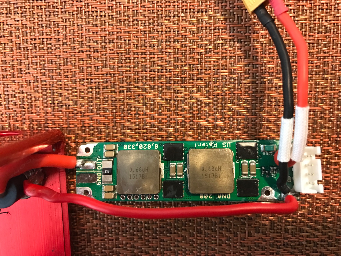

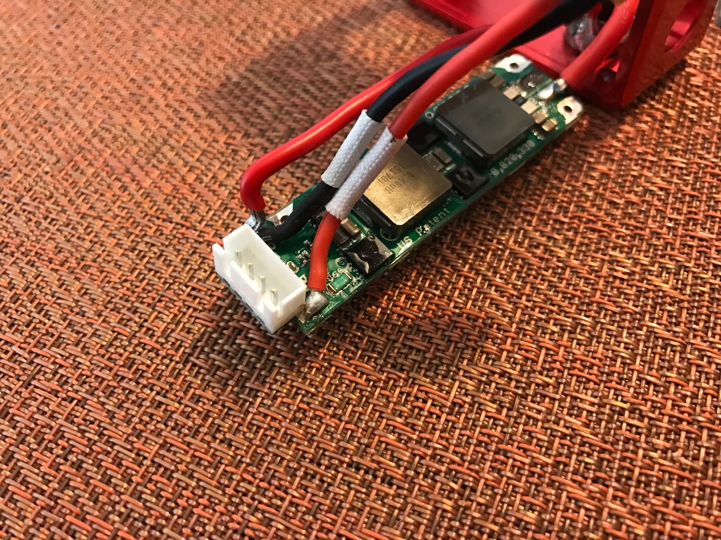

Here are some photos of the second chip. I appreciate the help from the members of this forum. I'm glad to hear of others great experiences with the company, it just rubbed me wrong when the response from Evolv was to pass the buck onto someone else.
I appreciate the info Awsum. Unfortunately, I changed out the connector, hooked the battery up, pressed the fire button and the mod wasn't showing any battery icon on the screen, nor was it charging, and escribe was showing straight zeros. So, after dumping nearly $80 into fixing a $180 mod, I've decided I'm done with it. The mod and everything along with it is in the trash can, and seeing as Evolv told me that they can't do anything since it is "likely a short in the 510" which was proven wrong once the second chip was put in, I will no longer support the company. At this point I feel burned, spending that much money on a mod only to have the first chip randomly fail after 6-7 months, and then have the second chip not recognize a brand new battery. Just evidence of a cheap company taking advantage of a market with cheap crap destined to fail. /endrant.

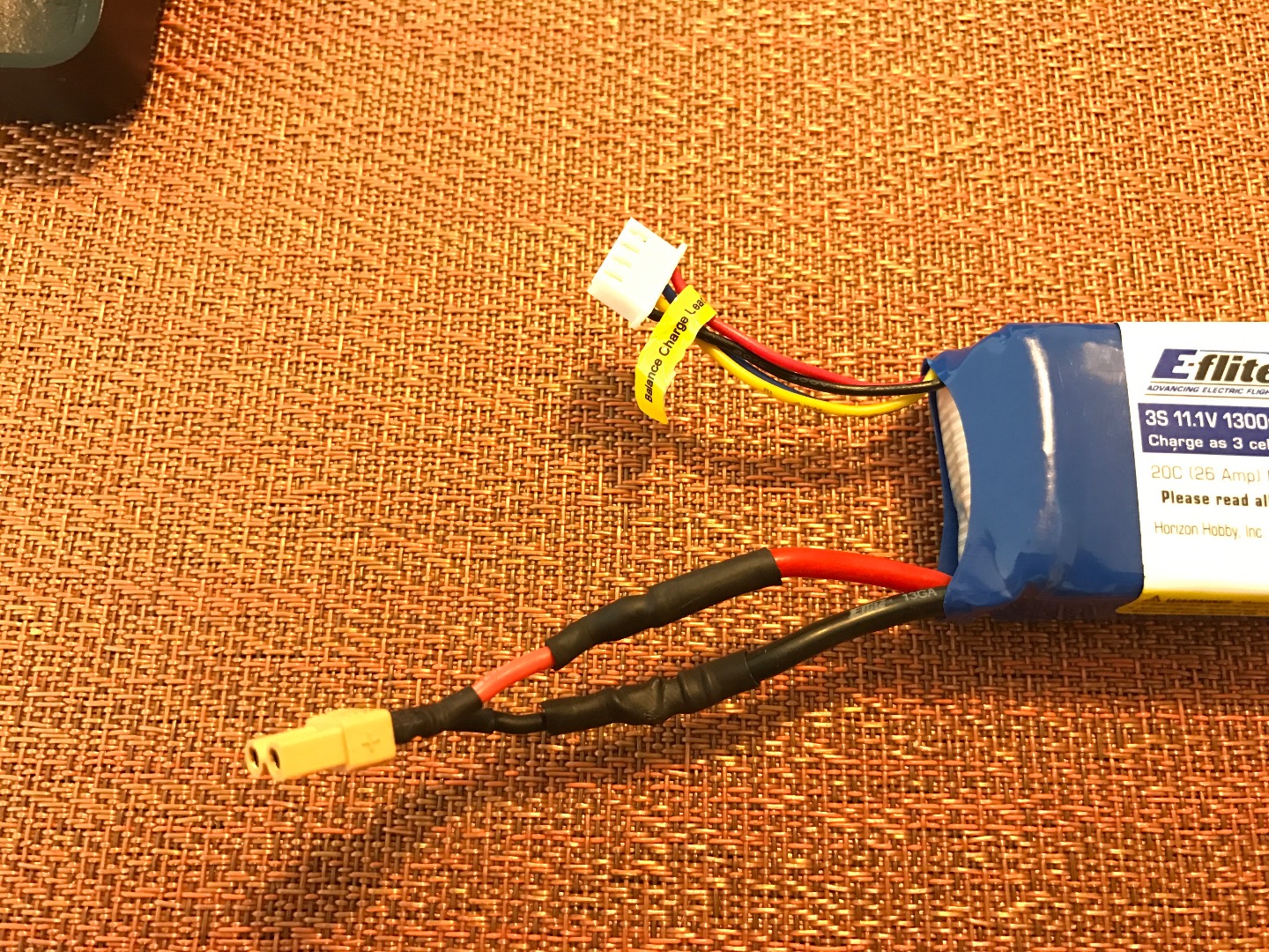

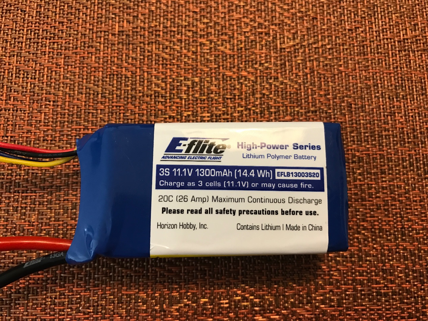

So one last question for yah VapingBad. I bought a new lipo for it, the other didn't seem to be salvageable. I managed to find another 1300mAh lipo, also 3s, same 11.1v, but the replacements look to mostly be a 25c-50c discharge rate, this one is 20c (25c max). Any idea if this will be safe to run?

Thank you so much, I did this and it appears to have worked. On to a separate issue now though unfortunately. So I put it all back together, threw it on the charger and it seemed to be charging intermittently. I plugged into my PC and ran escribe, did a hard reboot, updated the battery settings to 1300mAh and now it doesn't look to be charging at all. I did get the "imbalanced battery" alert a couple times. I would guess that maybe the battery is shot due to sitting for roughly 4 months not being charged or used? I know LiPo packs can get finicky when they're stored. Does this sound like a fair guess?
So I was attempting to repair my Efusion DNA 200 with a board transplant, everything was going smoothly until the 510 ground pad on the transplant board began pulling away from the board, while trying to maneuver the board into place, it finished itself off and tore off completely. So, my question is, is there a SAFE alternate place I may be able to ground the 510 or is this board junked too? Thanks!!
