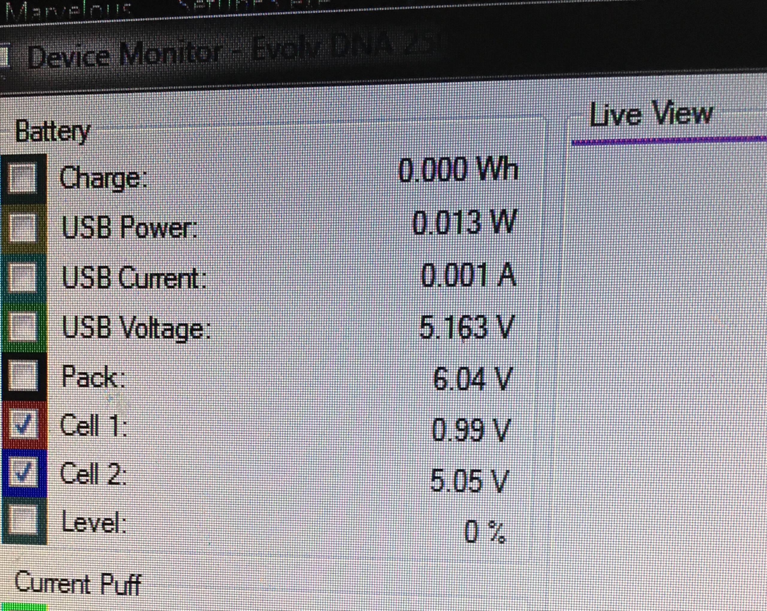

  2. I see, these are nearly fresh batteries and I was thinking cell #2 was reading the right amount.. Is my only course of action to file a ticket @evolv? or is there something I can do about it?
  3. Damn, it's okay. Atleast I got a lead, I'm not so sure if the problem is internal or external tho.

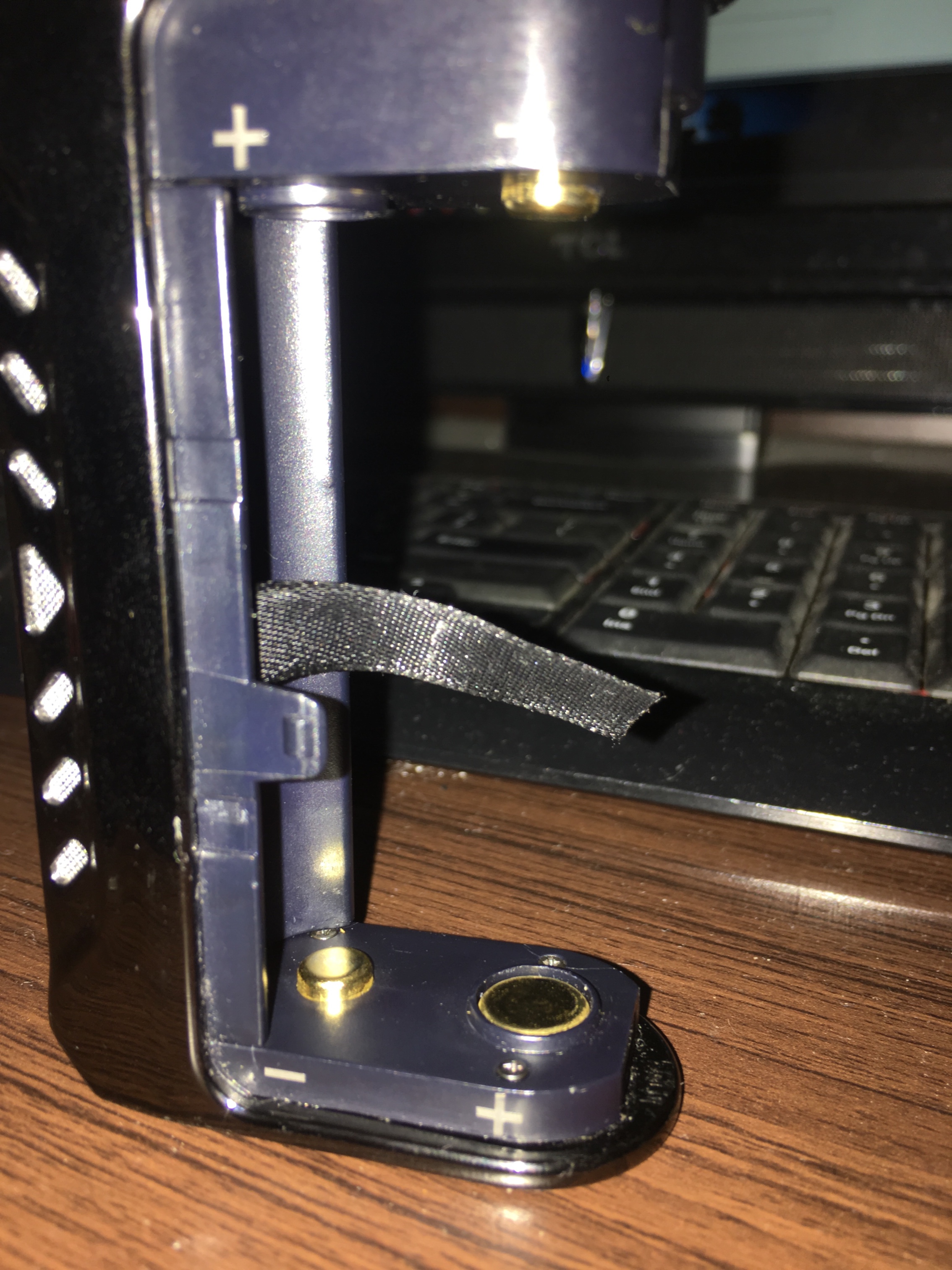

  4. Hey man, Looks like you're right, cell no.1 is not making full contact no matter what battery I use in it. Even tried mixing it up, it was always cell no.1 ...what do I do?
