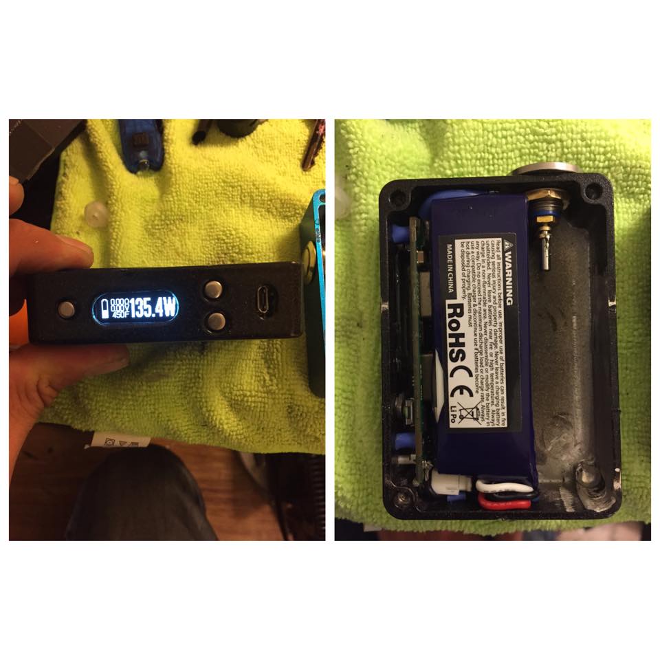

  2. Ok...random thought here...how about something like 950mah 3s, in P or P+ size box (which is pretty compact...and bump charge it through the day with something like this: http://www.amazon.com/gp/product/B00G0AMUE8?psc=1&redirect=true&ref_=oh_aui_detailpage_o01_s02 Drill out a hole or two to set the bottle up against the wall and the board as close to the wall as possible. Cut the wires off the pack short and use bullet connectors and that should save some space. Maybe move the screen to the back and flush mount. Not saying it wouldn't be tight, but you should be able to squeeze it all in, depending on the size bottle you try to use. (See attached pic for simple interior shot with a 950mah 3s and a510 on a P box) Then through out the day, just plug it into that lil' Battery Charger, which is small in it's own right (3.5 x 1.7 x 1.7 inches)...shouldn't be any more inconvienent then carrying the 5-6 batteries you say you go through a day...I know when I was running that 950mah as a temp battery, I could make it through 5-10ml on it, @ 40W and ~450F...if you are only running 20-30, it should last you even longer. One thing to keep in mind with Lipos, they don't have the voltage drop 18650s do, so they tend to last a little longer Just a thought for ya...
