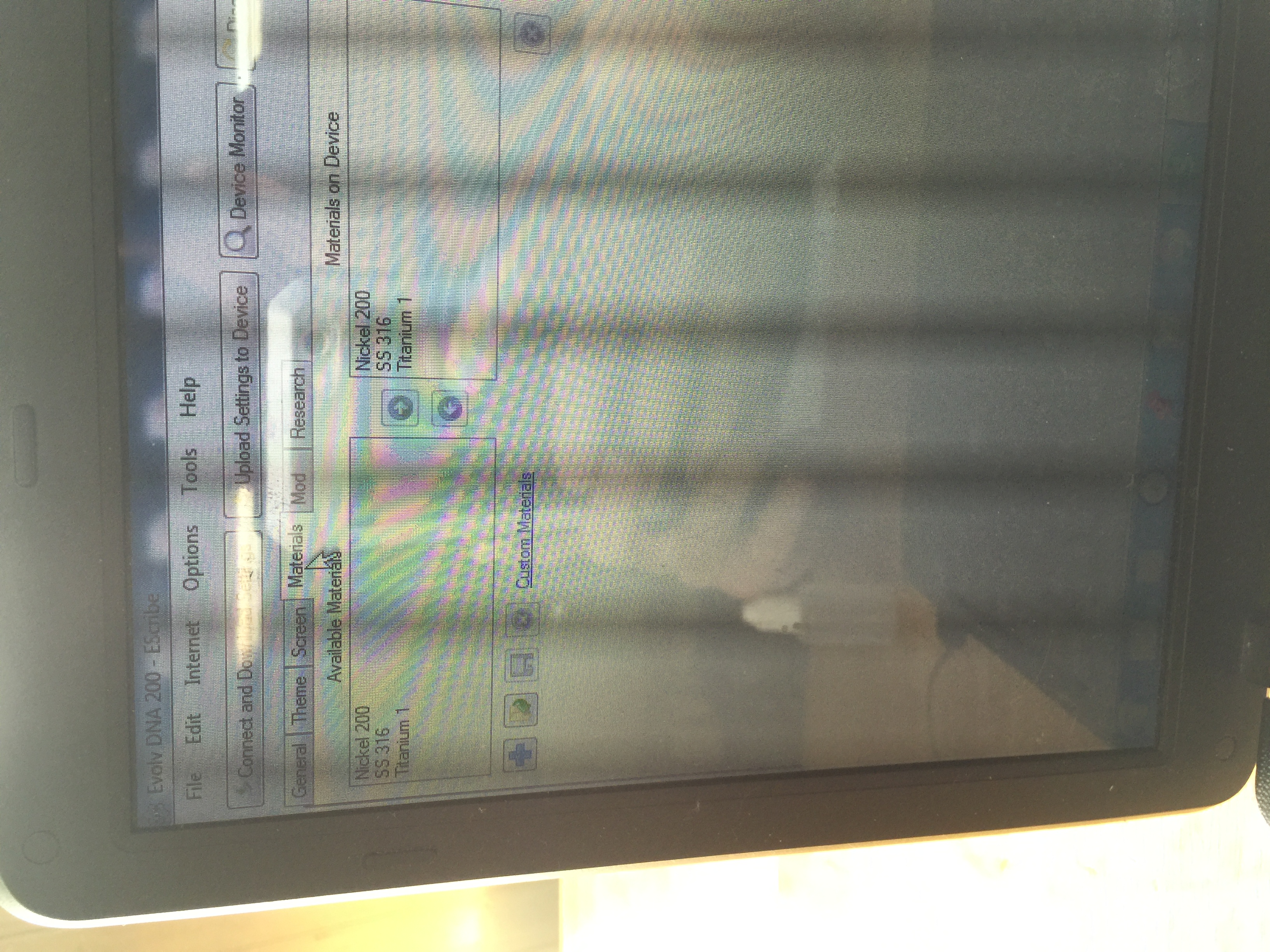

  13. I recently picked up a cloud maker white DNA 200 from a friend of mine an have updated my escribe and uploaded just one stainless steel profile and for a while it worked then it flashed a temp protected warning and when I took the atomizer off the mod and put it back on I said yes it was a new coil and now it's kicking out of TC what have I done wrong ?

  18. No the .006 is the tcr value of the stainless for some reason no matter how much I set it if I unplug mod go outside vape come back in an plug it back up the tcr value on both mod and just in escribe changes

  23. I set it exactly as it says for SS an every time I unplug mod an plug it back in it changes
  24. For the longest time though my stainless was working fine just within the last few days it has stopped working an I can never get the tcr value to stick either
