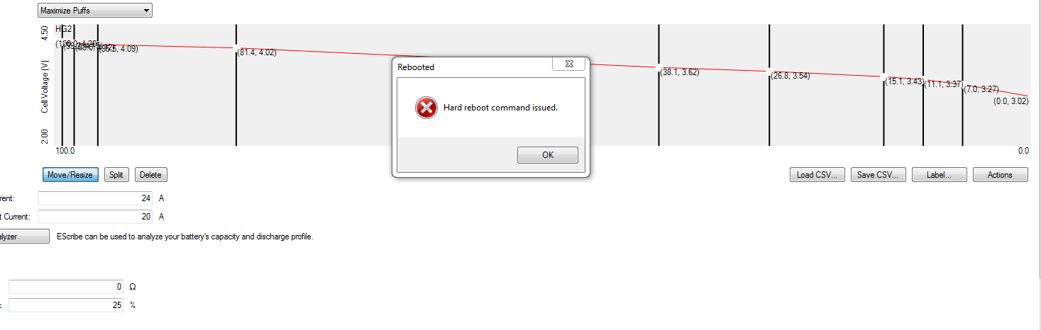

  4. I have set it to 0.004, is that my hard reboot working?

  8. I have changed it, and nothing happens. It always read 0.276 that should be 0.281-0.283. thanks for your help anyway.
