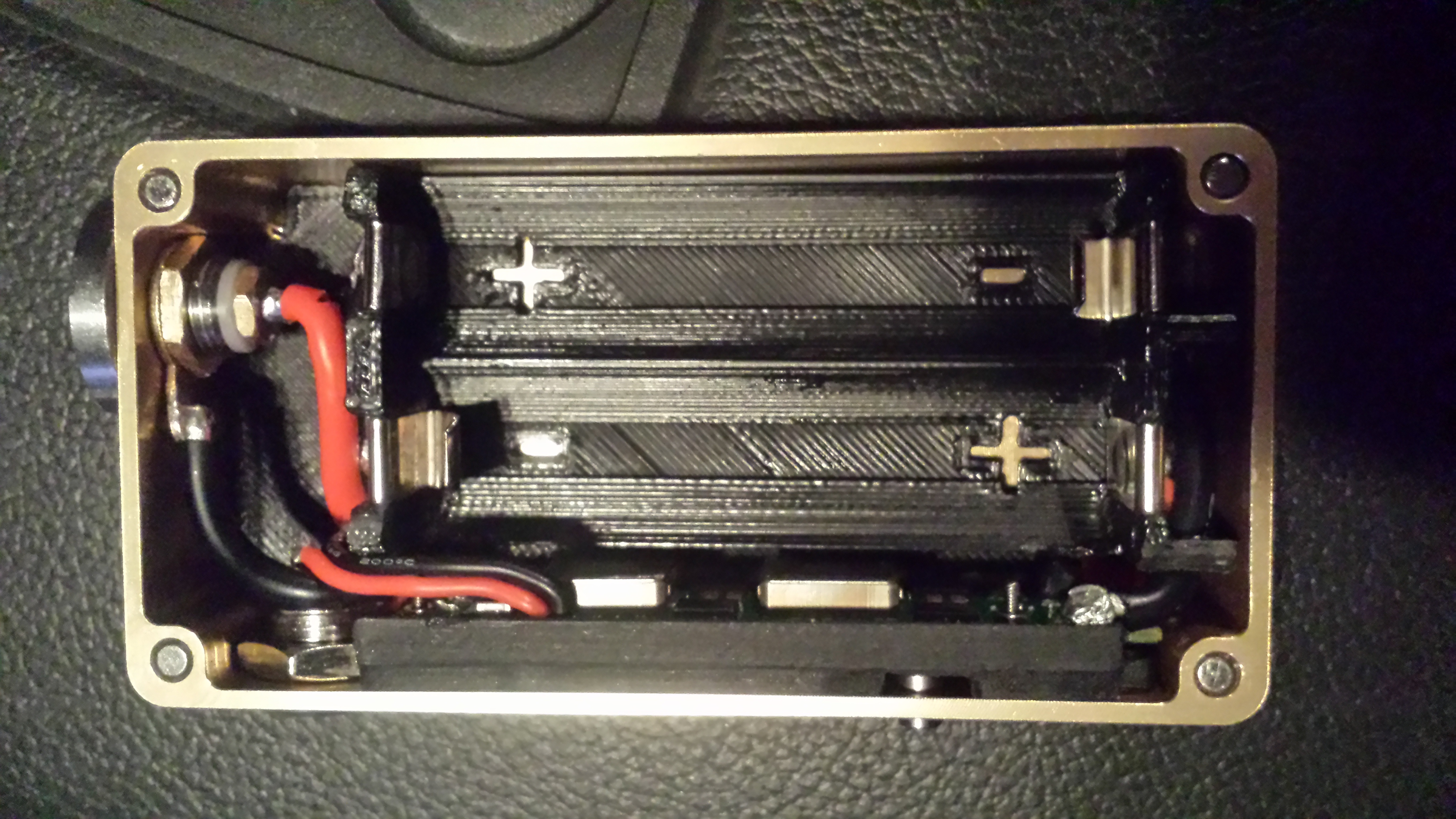

Okay thanks. I am trial and erroring right now. I took the board out and desoldered the external switch, tested and no change. Then desoldered the out and gnd, tested and no change. Then before I disconnect the power I cleaned the board with rubbing alcohol and now the board is working. So i hope something as simple as that fixed it so I am going to put the board back in and hope it keeps working.
Cant really get a closer look at the soldering but im postive there is no solder there. Also i am using onboard firing buttons so no solder around there. Funny thing is I use the device monitor and simulate buttons and use the fire button in escribe it works fine. Fire it and change the wattage. But as soon as I leave device monitor and disconnect from escribe the fire button doesnt work and like i said the up down buttons will fire and keep firing. Also in escribe in device monitor the screen dims and functions properly. Not connected the screen stays full.

Hi I made a custom 1590g mod. All soldered up. Used escribe and set to 2s. Dna200 turns on and fire button unresponsive. I have external switch. Switch works fine. But when I have a atty on there and i hit the up or down button it will autofire then i quickly have to take tank off or hold one of the up down buttons and it will quit firing. It also says warranty service when it starts up. I have 2015-10-21 EScribe 1.0.35.2 installed. I even tried other firmwares. Using escribe and the simulate buttons it works but on the mod fire button doesnt say anything and up down all they say is check atomizer.
