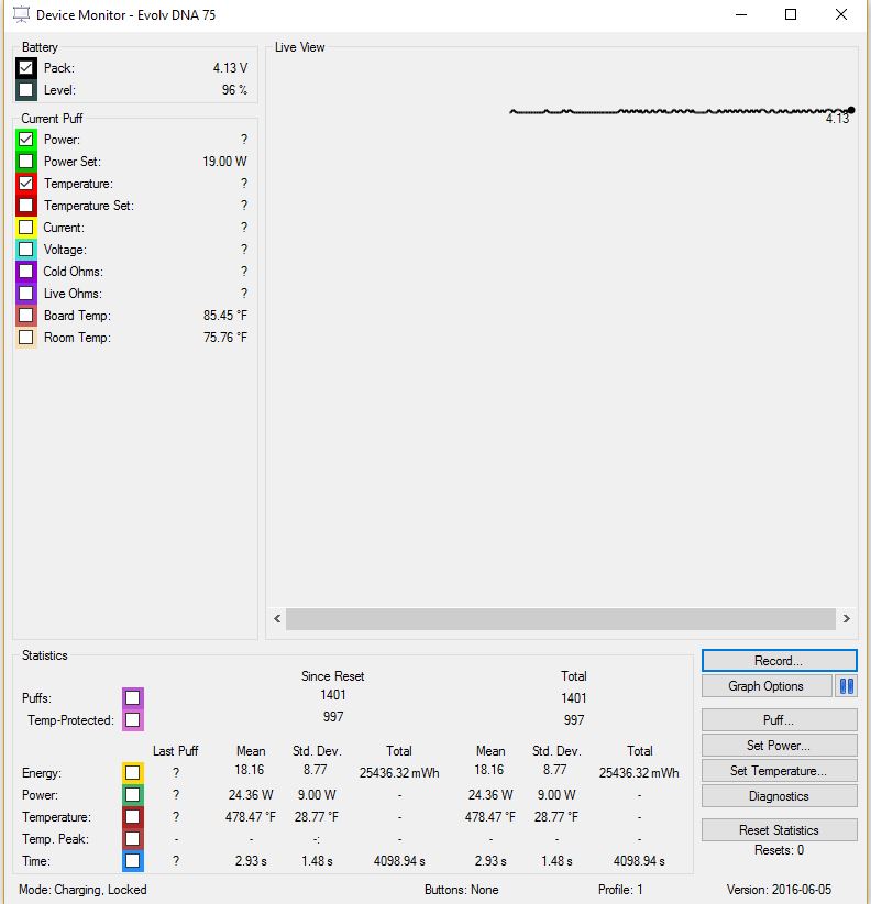

  7. As you can see, no charge rate monitor
  8. The device monitor displays a flat signal of battery voltage with an occasional small blip when it reaches 99/100. I'm not seeing charge rate on it at all. Battery analyzer isn't working no matter what, just says waiting for full charge
  9. Thanks for the response. Besides the Csv curve for the battery, I am using default settings that this box came with. The light will not turn green at 99 or 100 and the lightning bolt still does not go away
  10. So I'm having virtually no problems with this mod and am really enjoying it. However, when plugged in via USB, the mod tops out at 99% charge (virtually brand new Sony VTC5). Problem being, when it stops at 99, my light doesn't turn from red to green like I have set up in escribe, and the lightning bolt symbol on the battery indicator doesn't disappear. When plugged into escribe at "99%", the device monitor shows a nearly completely flat signal for the charging voltage which I assume means that it isn't charging anymore. However, like previously mentioned, the lightning bolt doesn't disappear and the battery analyzer cannot be run, stating "waiting for mod to fully charge". I have just uploaded the CSV file for a Sony VTC5 and the mod is currently at 94% plugged in. Any suggestions if it still doesn't reach 100%/green light/no lightning bolt? EDIT: I have gotten the device to display 100%. However, the charging light is staying red (supposed to turn green at 100% as set in escribe) and the lightning bolt symbol remains
