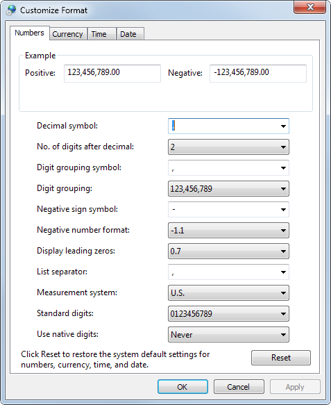

  3. As I said earlier, I've proven it to be a Windows Driver issue; and that I am open to suggestions ... So yes, my number formats are correct as well. Drivers in question - DimensionSerialPort.sys & WdfCoInstaller01009.dll. I just need to find what (hidden) device is using which set of drivers incorrectly. On my machine that IS working to Mods are using COM port 8. I'm not sure if this is the default port and still investigating the driver versions.
