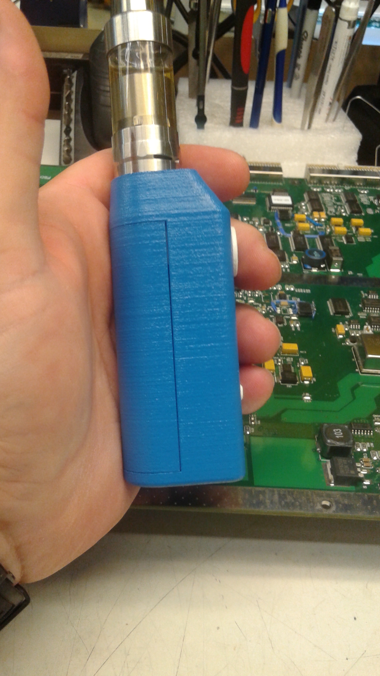

  1. My first DNA75, I have another in the works. This is 3D printed from Shapeways, my design, with an Avid 510 and Keystone battery contacts. Painted with Duracoat ceramic paint. Every other mod I have made has been black or dark grey, wanted some color in my collection. Comes out at 1.5"W x 1"D x 3.8"H.

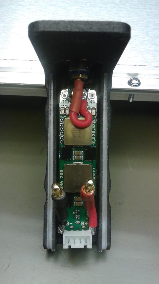

  2. TheMadKracker
