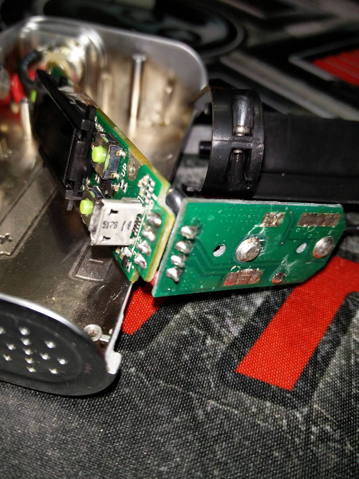

Bill - yes changing it to Power Supply actually worked! Unit is staying on and firing fine. Battery indicator isn't working but its working. At least i can use it now while waiting for Evolv support to get back to me. Vaping Bad - Just opened it up and looked fine. i verfied with multimeter from the reverse protection board to the chip and its a clear path. Thanks everyone for the help.
If you got time Bill, can you post a pic of yours? Should be the same but....
Hey BillW50 - I didn't want to tinker around with the the connection between the two boards. connections seems solid and i am getting proper V readings and such.

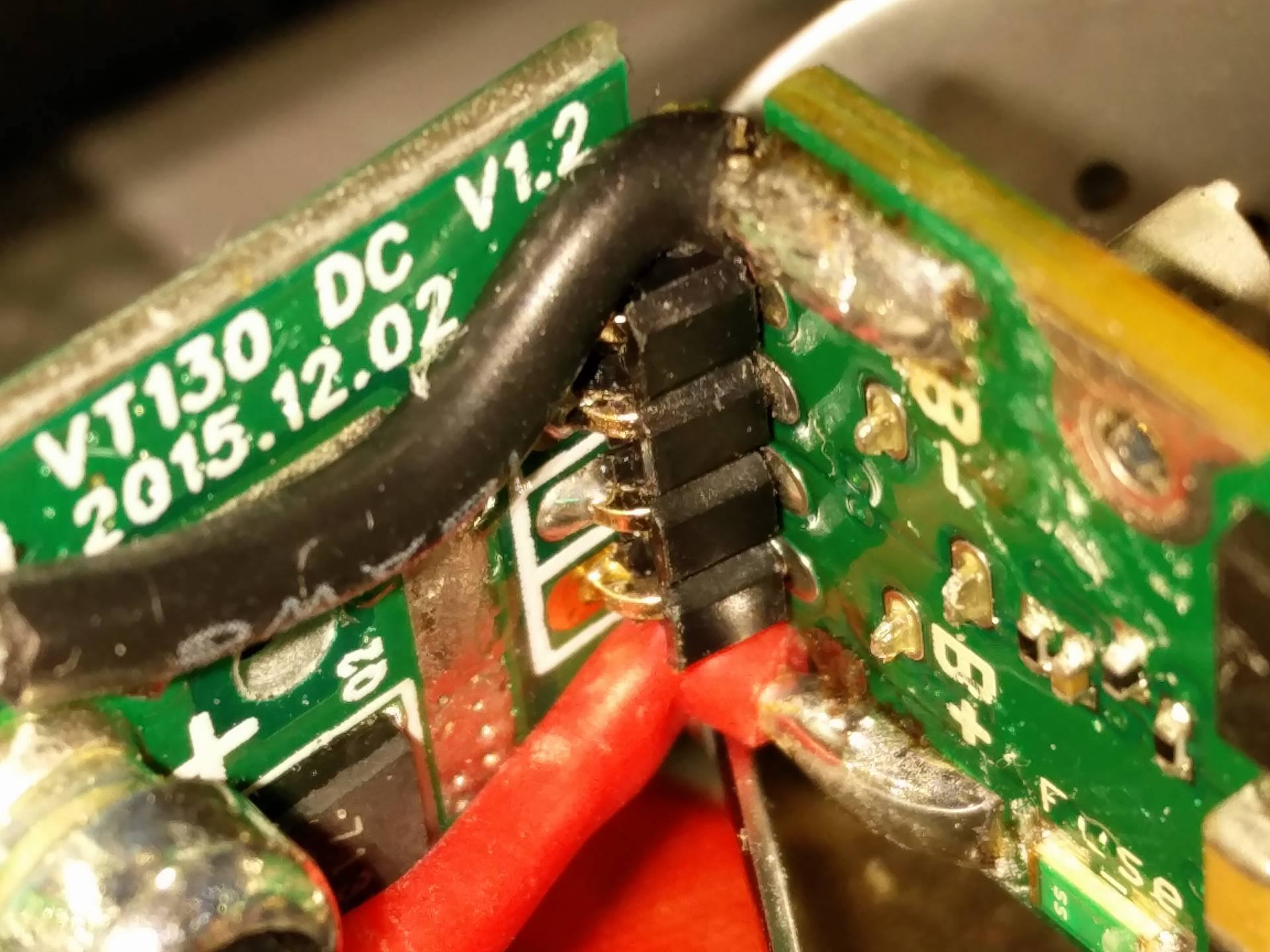

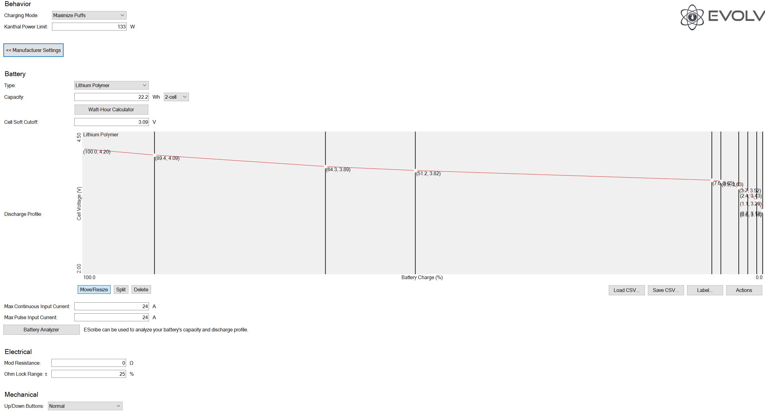

Guess here's a bit more info: - I had this working fine for 2-3 months then it just stopped working one day. Never been dropped not exposed to water - I've tried numerous batteries, they're all the same results. - Verified if the fuse was blown, its not. Read somewhere on this forum to jump the B+ and skip the fuse, still nothing. - used a multimeter to verify all pins from the reverse battery protection has good paths to the DNA200 board. - verified there is 7.4V going into the DNA200 board - checked the entire DNA200 board to see if there is any other burnt resistors, nothing wrong that I can see with a flashlight and magnifying glass. As for the support, I went to http://www.evolvapor.com/index.php, Send message and it brought me to http://helpdesk.evolvapor.com/index.php?a=add to create a ticket. I dont see any other way to contact Evolv. Attached are pics of escribe. Thanks in advance for any help and suggestions.

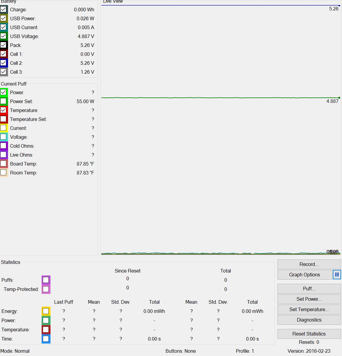

hey guys, i got a VT133 that isn't firing or staying on. Whenever i hit the fire button, it turns on but the moment i let go, it turns off. Batteries are full and i checked the board for any blown resistors or fuses and it seems to be all checked out. When plugged in, the battery indicator shows empty and no lightning bolt. no charging. I've already tried all versions of firmwares, battery is set to 2S 12.2whr(LG HG2) Device monitor shows Cell 1 5.65V, Cell 2 1.26V pack 5.25V I already tried contacting evolv but no response to my ticket for the past 5 days... any suggestions? Video of issue https://www.youtube.com/watch?v=kbNbS0Q5iGU thanks
