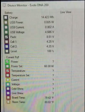

    Edmonton, AB

  1. Thanks for the replies guys and sorry for the late reply on my side. Still on vacation in HI. this is my 4th 2s build on a p box, i've built a few other 2s boxes as well but this is the first time i ever came across this issue. Yes it is a 3d printed sled from modsledz and i never had an issue with them. maybe this time it is the connections on the sled but wasn't quite sure as escribe did show up proper volts. The chip was from a working reauleaux dna200. I'll take a screen shot of the power graph when i get back home in a couple of days much appreciated in the responses!
  2. yes 2s and uploaded.

  9. The power from the daughter board to the DNA chip was ~7.4v. I can't see what else is wrong unless its the DNA chip itself. It is working in Power Supply mode but the moment i change it to the Lipo in 2S it just doesnt stay on.
