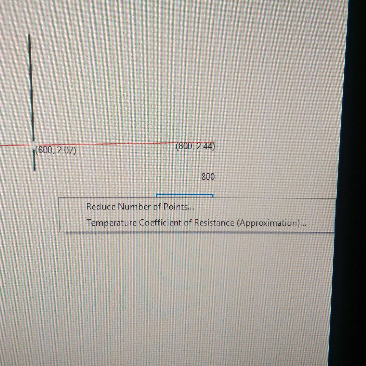

  7. good point i just looked and noticed as well they took it away or i just can't find it. the box that lets you input your own TCR value is no more? that's a bad move. it was so nice to be able to just throw a tcr value in and call it good. i was hoping for a tcr adj from the mod itself, TBH. like joyetech, yihi, or sxk.[/QUOTE] You can change the TCR under the Materiel tap. Mark one of the material and you get the values up and can then change TCR there.[/QUOTE]my man flem! edit..... i spoke too soon. ok so i go into materials tab, then select a material from "available materials", where is the option to change the tcr? all i have at the bottom is the 'move' 'split' 'delete'. where's the 'action' tab? to make this clear, i'm using the new escribe james just put out a couple hours ago. i realize the old escribe had this. but i can't find it on the new escribe.[/QUOTE] right side of the screen, under the graph.
  8. I clicked on material then selected ti then clicked actions.
