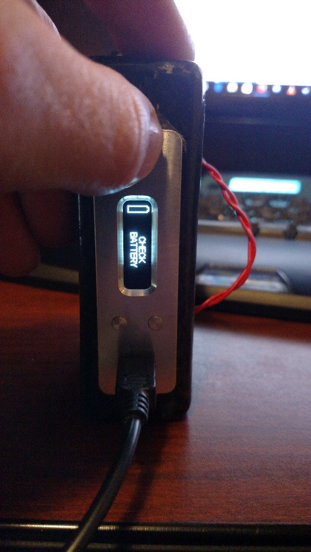

  4. Hello all, hoping to get some help here. I'm running into issue with the board not staying fired up, with 2 fresh batteries installed and holding the fire button it will cycle through : Evolv DNA 250, Check Battery, Then display current wattage settings, the battery indicator "which reads empty" and the Ohms, Volts, Amps... all which read zero.. I've checked my power coming into the board from the battery sled, reads 8.32 Volts.. I've gone in and set the configuration for 2 cell, Tried 2 other batteries that are also brand new, Pulled my board back out, checked all my connections and solder joints, reassembled and still same results. Any help would be greatly appreciated.
