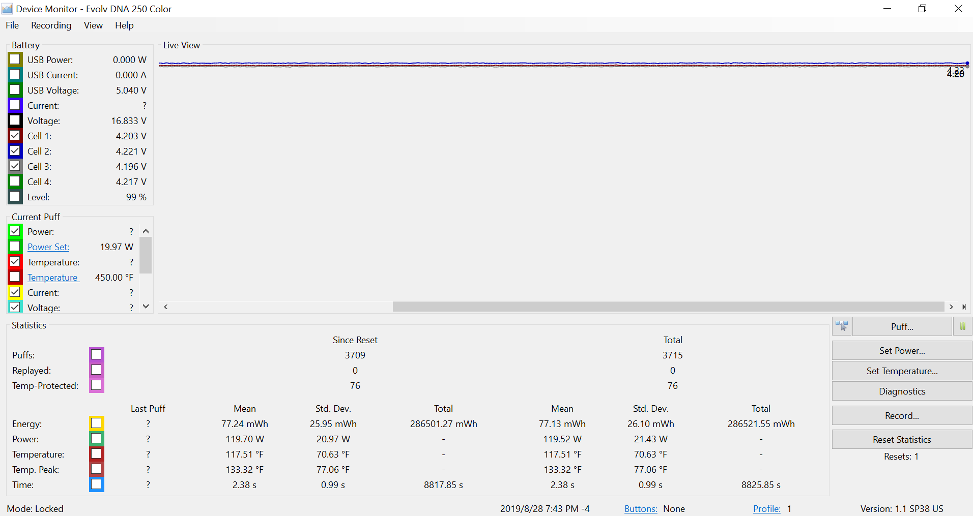

  1. The pack has been sitting the mod plugged to the charger, the battery is currently at 98%.

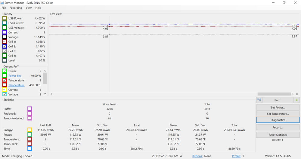

  2. SUCCESS, the pack is now fully charged and balanced. After I removed the pack from the mod, it still would not balance charge on the external balance charger. What I did was discharge the pack to the storage voltage level (3.8) and started a balance charge again, that seems to have done the trick. Hope this helps someone else that has a similar issue.

  5. Current screen for reference.
  6. no, cell 3 will be around 3.9 and others are 4.2. I would assume that the pack percentage would be higher than 70% at that point.
  7. No, it will not balance charge in the device. The best I get is 70% in the device.

  11. I have a DNA250C with a Hyperion 2800mah and looks like the charge percentage is off. I have added an image from the Device Monitor screen for reference. Has anyone else had this issue and what could I do yo fix it?
