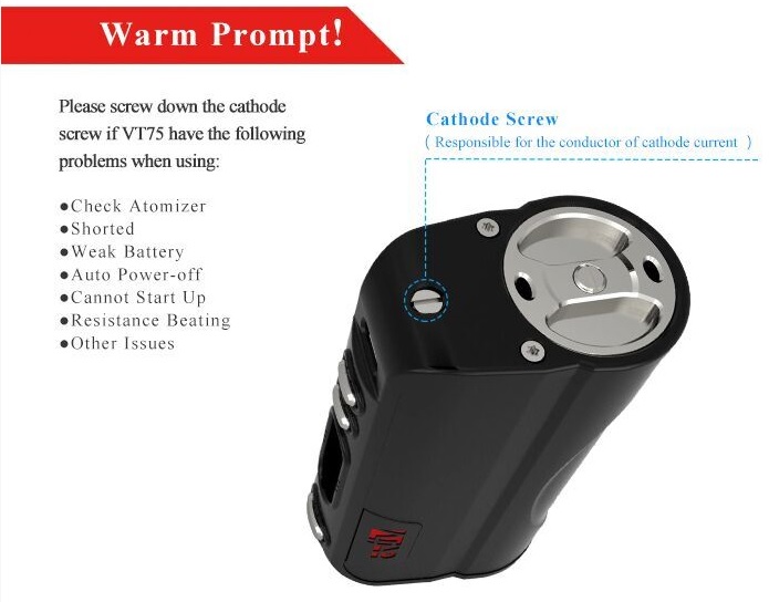

  7. I had similar problems to you with a Hcigar VT75 and a crown tank. Turned out it was just a loose cathode screw. Was easy to fix and haven't had any problems since. Even have a Crown 2 tank with .25ohm coil and works great. Good luck

  11. Hey Guys, I may have fried my new laptop while charging and taking a drag at I think around 70 watts. Or at least it happened right when I did take a puff. At the time I did have a loose screw from the negative terminal and the DNA75 was acting strange. Which I thought normally charging is disabled when you hit the fire button. Is that correct? I got a usb meter and only measured .8 amps while charging. Scared to try it again and monitor when I take a puff and damage laptop after I got it repaired. Can't find any info online about the current ratings of my cheap ASUS laptop. Thanks for any help
  12. Had this same problem with tons of strange error messages. Figured out it was just loose screw on the bottom. Tighten up and has been working like a charm since. But I damaged the bottom by over tightening the battery cover. It kind of bent the bottom case. Since its not a defect I can't claim warranty. Thinking of disassembling and bending it back.
