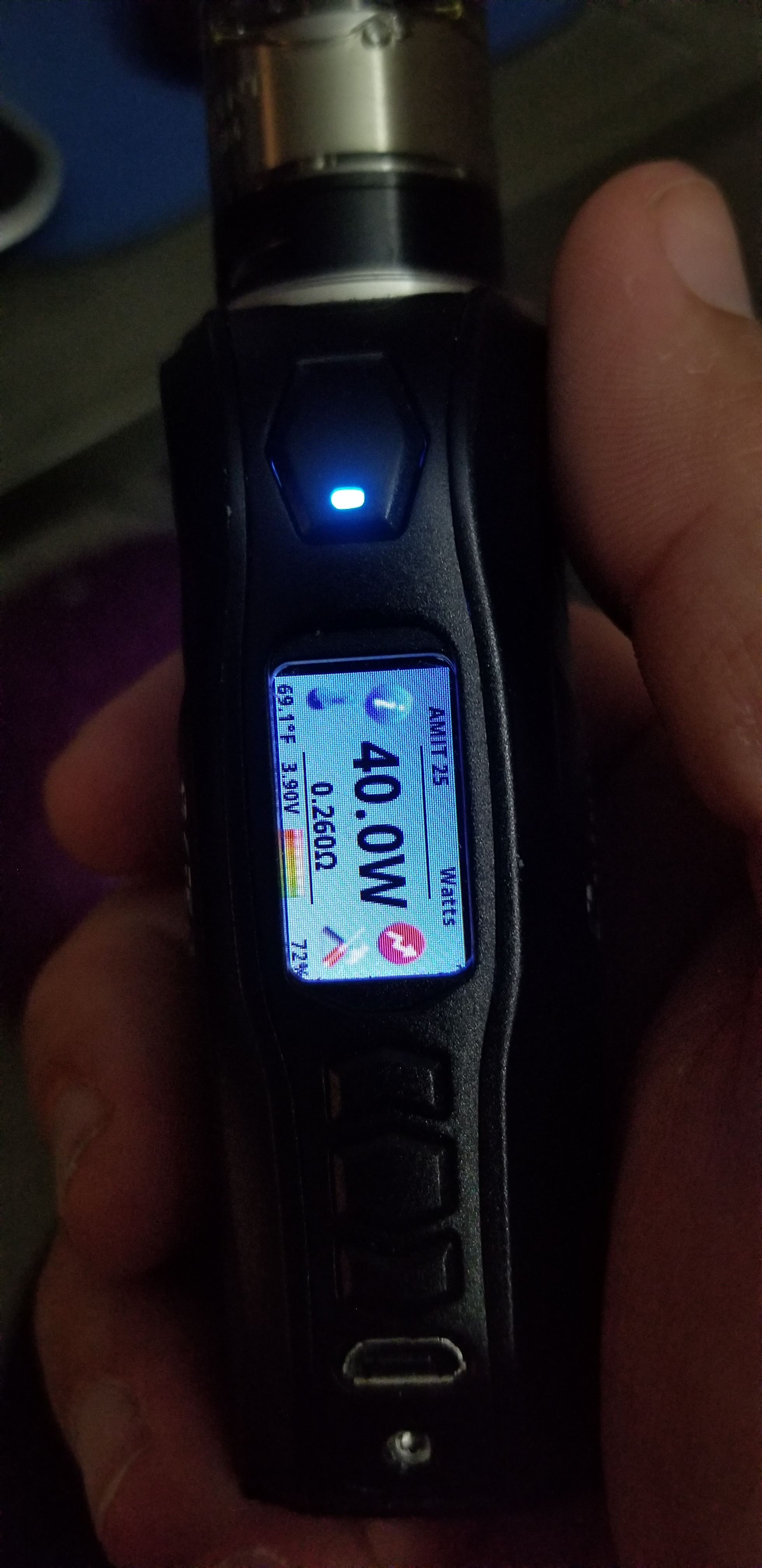

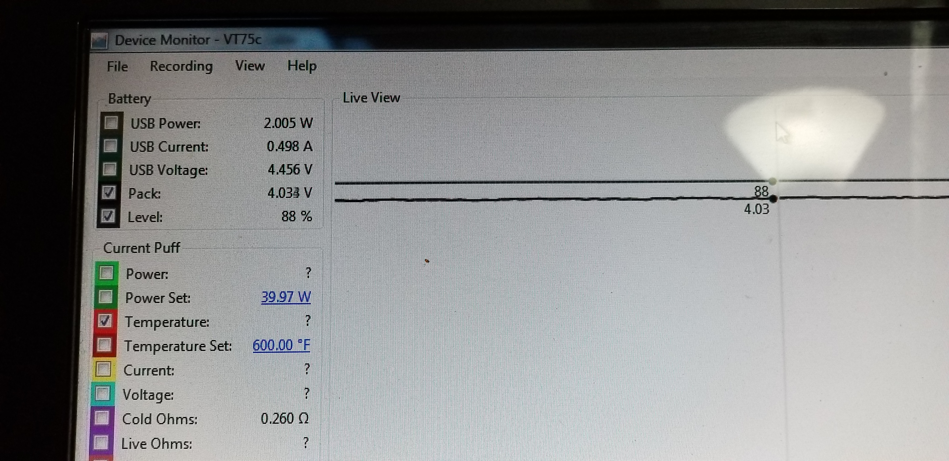

	Hey guys. I have a 26650 vt75c. The battery meter on this mod is driving me nuts. I put in a fully charged new high quality 26650 and it will never read 100 percent. Even though I know the charge levels and they're 4.2-4.18 and I have the CSV set to read 4.18 as 100%... It will read in diagnostics directly on the board as like 4.15.. Then 6 puffs later I am already down to the 80 percent range where it will hang for a while. Overall the battery life is not a complaint but I'm going nuts trying to get this damn thing to read hallway accurately. I am OCD about this stuff I admit, but something funky going on here. I know this mod has a very bad rep as a damn pipe bomb, though I've fixed the issue myself with a home made insulator so no worries on that particular issue getting me hurt. Another thing I notice is that the screen will say a certain level, such as 3.77 and 75% but as soon as I plug it into escribe it will show a much higher level and percent until the moment I unplug the USB. Thing is, if I take the battery out right away and read it externally the higher reading that escribe showed is the correct reading. So I'm getting a ton of voltage drop. I know this board isn't as efficient as the others but nearly a 10% voltage drop just doesn't seem right either.. I'm open for any suggestions you all may have for me. Personally I'm wondering if there isn't some sorry ass soldering issues behind this and might just tear the mod down and rewire if no one has any other suggestions. Thanks Pictures are taken seconds apart. Mod screen showing low, escribe high

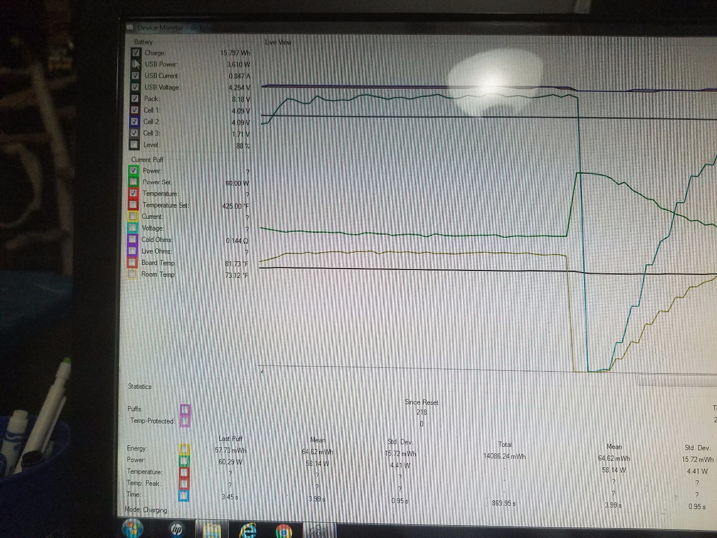

	  250 board won't fire with usb plugged inJvape78 replied to Jvape78's topic in Batteries and Charging No! That's the main reason why I wrote this thread lol ... got me stumped. The device will not normally fire while plugged in to a USB wether it be connecting to escribe or just a wall charger. One time out of 30 it might actually fire and not say check battery. I did notice the cell 3 fluctuate while fire. Went from 1.8 to 1.2 and everywhere in between.. Thank you for your help so far btw, greatly appreciated. If you need better quality images I can get screenshots off the computer I just have to log in evolv forums and I was being a little lazy earlier I guess with the phone pics.
	  250 board won't fire with usb plugged inJvape78 replied to Jvape78's topic in Batteries and Charging Yeah I believe so. If I had accidentally switched the taps that are supposed to go to positive battery end over to the negative end then I would think that would cause the board to not operate. No? The mod runs great. It's just seeing the cell 3 have that high of voltage and the non firing when USB plugged in. Other than that no issues at all...

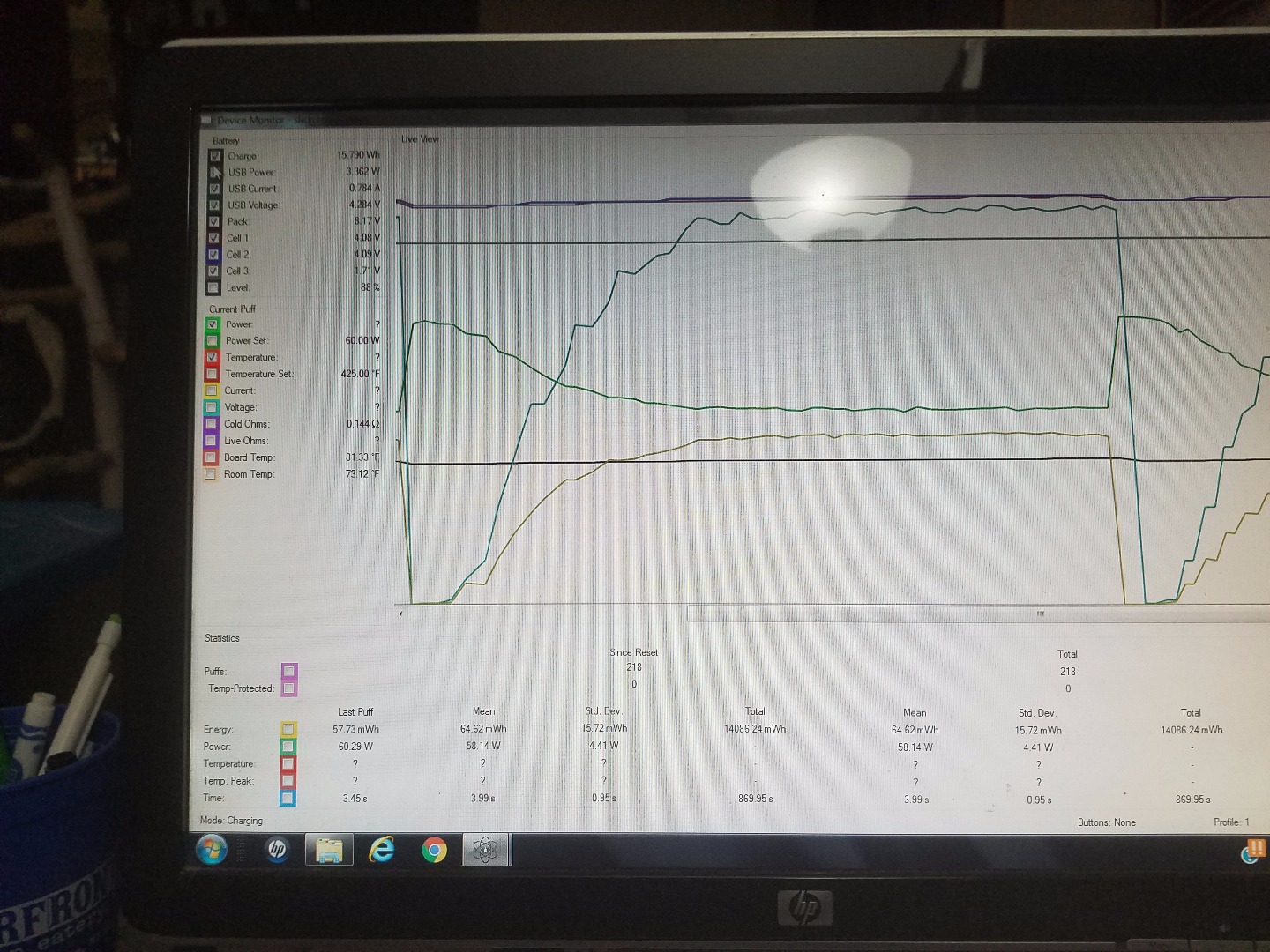

	  250 board won't fire with usb plugged inJvape78 replied to Jvape78's topic in Batteries and Charging Hey I've made a few dna mods and have a little experience. However , this dual 18650 build I just did with the new 250 board is giving me a little resistance. When I plug the USB in and go to device monitor panel my cell #3 reading seems very high at 1.79v. Now the total in the battery pack column only includes the value of cells 1&2 but last time I checked I thought 1.2-1.5 was where evolv wanted the 3rd cell to be (or under that). The second thing is that if I push the fire button with the USB in; I will get a check battery or wreak battery window and it will not fire. Is this something evolv did as a safety feature for the 2amp protection or is something funky going on? Thanks!
	When that happened to me it was 2 things. First I didn't have a great connection on my sled. My first time soldering and the work was rough. Once I redid that it was still doing the flash so I tore it down and inspected every single connection. Come to find out one of the pins on the balance tap that solders to the board had broken connection at the board joint. Once that was re soldered it worked great. Good luck.
