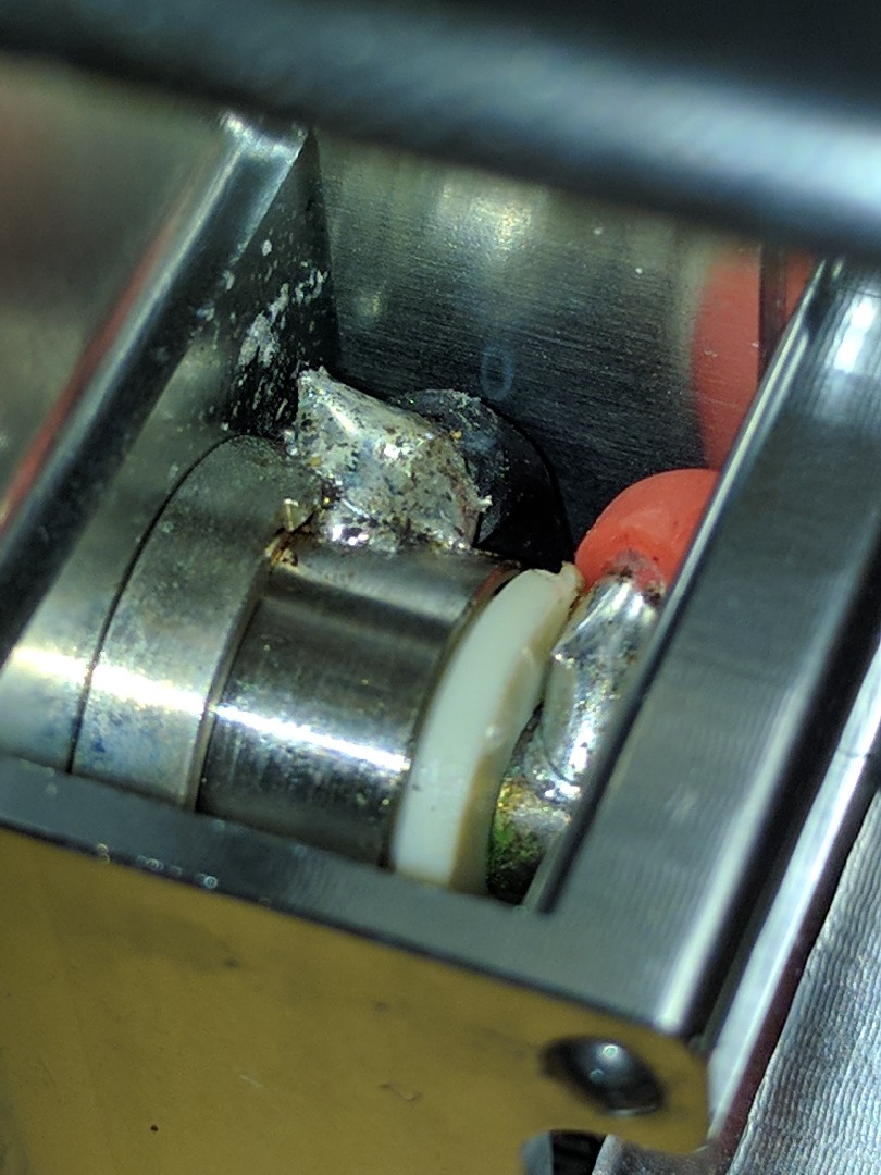

So ATM there are two possible way to fix this damn mod, the issue is caused by the not so proper connection between the atty gnd and the board ground (caused by a silly engineering by hcigar) overtime the 510 plate will oxidise and fucks up the gnd connection (crated by the 510 top plate, the black plate just down this one and mostly the entire body) First way to fix her (and easiest to do) is by remove a thin layer of the 510 black plate (just under the removable 510 hybrid plate) with some sand paper (i used 180) then wrap with an aluminium foil the outer part of the battery box (not the board part) till the inside, including the 510 (so in this way youre going to create a new conductive layer between the two parts of the body and between the two 510 plates) and then remove the excess over the positive 510 pin (just the center ofc) and battery. Second way (not so difficult but not so dumbproof like the first one) is to solder an electrical wire to the other ground connection on the board itself, peel the cable and leave it between the two 510 plates. plus if you want, add another one at the bottom of the board and leave it between the battery cap and the battery itself. (following this procedure you will have 4 wires in total soldered to the board instead of the original 2) For now i did the aluminium foil trick, will update in the next days/hours and see if there are still any resistance fluctuation overtime.

So, last week im back having issues with the ohms reading, decided to take it apart and found that one of the mounting screws was broken, the top left one, replaced it with a new m 1.4 x 5mm and tightened the other two, cleaned again the top 510 negative cap and is back working flawlessly. Must to admit now, this mod has a very great look, but the engineering is crap.

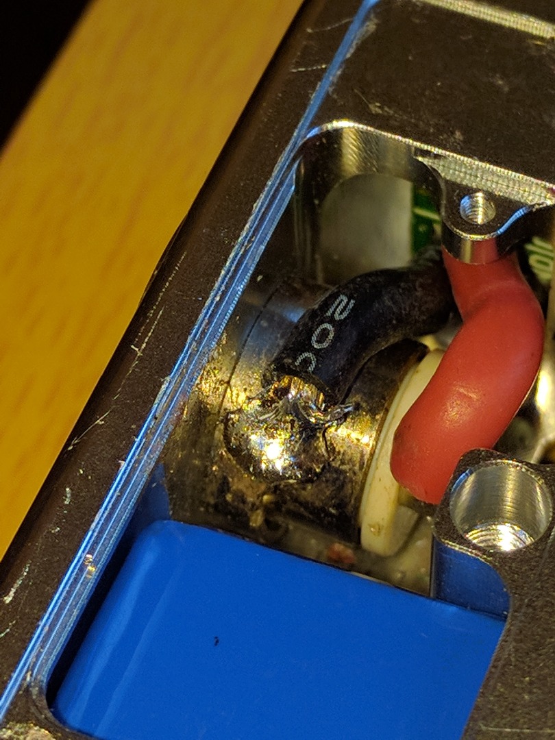

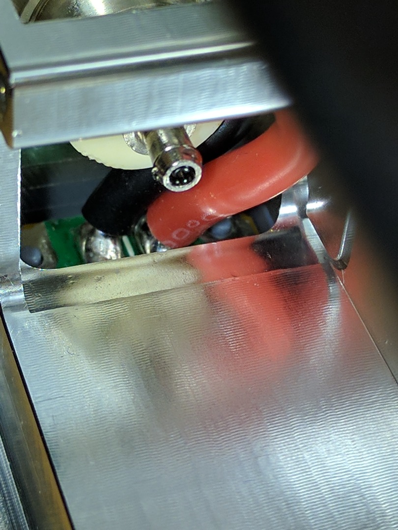

This is what I'm thinking as well, just asked to a guy on fb to send me a picture of his one. I don't have any clue regarding how to disassembly the box and get access to the 510. So I think I won't be able to do that so... edit: found it, had to remove the carbon fibre and there is a little slot to give access to the 510, soon ill try to solder both. but still i cant understand how is possible that this firmware is giving problems while the old one is perfectly fine and stable... Edit2: tested with a multimeter the 510, from the ground post to the outer 510 solder is fine, but the upper ring (chassis part) is not coming out at 0 with the 510. Tomorrow I'll solder it again... Hope is gonna work... edit3: before re solder the ground i decided to check if that was the problem, put a little wire between the chassis and the ground 510... and... rock stable after 2 hours of idle! tomorrow morning ill get the confirm if that was the problem so i will proceed to re solder it, but ATM im quite sure about this. Thanks @retird for point me out on that! edit4: no way, found her this morning jumping between ohms as always, ill try to solder it any way... -

How is it possible that with the old firmware (02/23) reading is rock solid as is supposed to be and with the SP3 (and SP2, tried just now) i have this silly reading? ill attach some pictures ive just got of the board posts and 510. While im using the SP3 readings are literally jumping from ? to the coil effective resistance, every second i have a different value, like ? .075 .150 ? .298 etc etc PS: 510 is fine, atty as well, no trace of fabric debris! -
