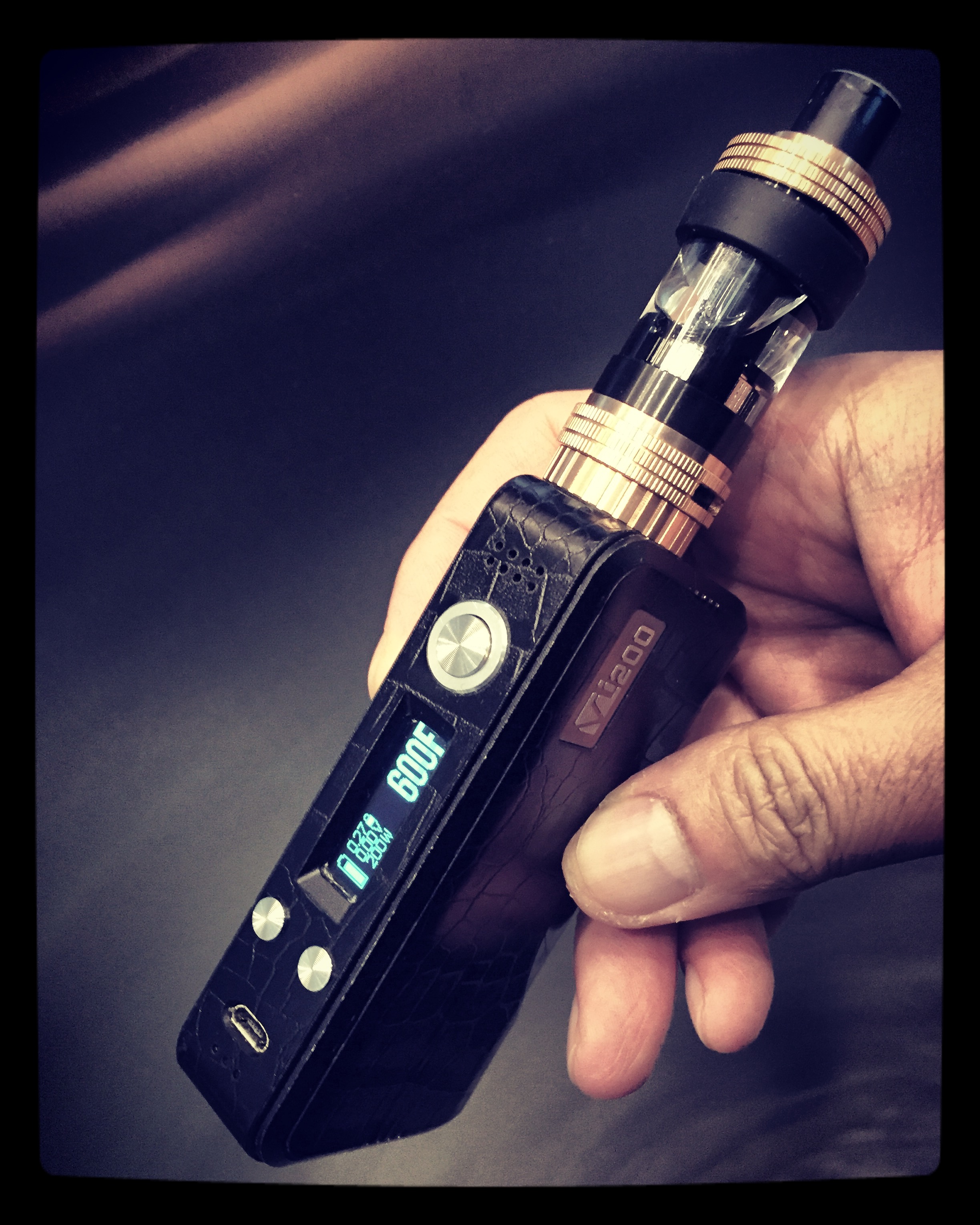

  9. First of all, greetings. This is my first DNA200 device (HCigar VT200) and thus my first foray into EScribe Software customization and also my first post in this forum. I apologize if this question has already been asked (or if there is a better place to post this question in), but my searches came up dry. I'm trying to set up Temperature Control for the Pre-built Uwell Crown Stainless Steel coils, particularly the 0.25 ohm ones on my DNA200. Since I don't really know the exact coil dimensions to input into the new Wire Wizard, I attempted to generate a .CSV for "DNA200 Output" using the "old" TCR calculator: http://www.steam-engine.org/tcr.asp The following options were used/selected: Temperature points (default): -100,0,70,200,400,600,800Select wire(s): SS 316L / Elite (TFR)Resistance: 0.275 ohms (Top reading of the Atomizer Analyzer)This was the DNA200 output that I downloaded into a .CSV file: "Temperature (degF)","Electrical Resistivity" -100,0.894808435072142 0,0.9588476571924915 70,1 200,1.0721420643729191 400,1.1702552719200887 600,1.2568175278497145 800,1.335482796892342 Which I loaded as a custom material onto my DNA200 via Escribe. As for the Profile settings they are as follows: Power: 120 WTemperature: 500 degFOhms Locked: 0.275 ohmsPreheat Power: 130 WPreheat Punch: 4Preheat Time Limit: 1s Perhaps it's working as it should, but it seems to me that it never hits the high watts like it does in non TC mode. In fact it seems to hit weaker than one of my DNA40 mods in Nickel TC mode. If anyone can give me pointers on what I may be doing wrong or if there's a better way to configure/set my DNA200 to hit 120 watts on Uwell 0.25 ohm SS coil with TC protection to offset burnt/dry hits, it would be greatly appreciated. UPDATE: I manually set the temp at the max 600F and the power at 200 Watts. Although the temperature protection kicks in at around 70 to 90 watts (or so), it definitely provides a strong hit for the tank. I can set the temp lower if I want a cooler vape. Although I have my doubts as to the accuracy of the actual temperature, it's much closer to what I want it to do. I'm keeping the Preheat Punch at 120 since that the "max" watts the coil is rated for. Still, if anyone has any insight on how I can make this more accurate, I'd love to hear from anyone else who has had any degree of success with the EScribe settings. UPDATE 2: If the rest of the thread responses are "TL;DR" for you I wound up using the TFR for 304 Stainless Steel, and it seems to work the best with the Uwell Crown SS coils in Temperature Control Mode. The input variables on the steam engine site are mostly for pre-planning a build. If you are only using only one wire material, the TFR should remain constant. Go into the Wire Wizard page, Select "DNA200", click the desired wire material in the drop down (In my case SS 304), then "Download TFR Table as CSV". That CSV can then be Loaded as "Coil Material: Custom" in one of the profiles.
